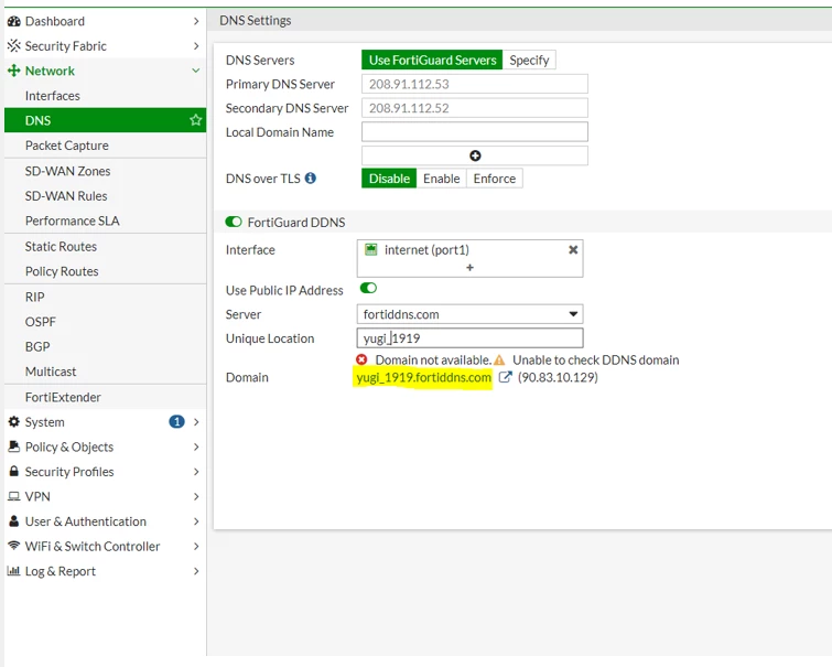

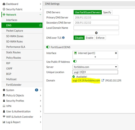

Below characters can be used as legit characters in defining a domain and getting it registered on FortiGuard DDNS servers.
“.” and “-”. Any other characters such as “>” “<” “_” “:” etc are not considered legit characters and as a result, the domains do not get registered.
Characters that would work
Notice here that only “.” and “-” are considered as legit special characters as part of a domain.
Whereas other characters aren’t considered legit and will always throw an error
This sometimes may show available too but in the debug output would always fail. Below are the examples of working and non-working setup
Working setup
# dia debug application ddnscd  -1
# dia deb en
# execute update-now
1636894422: Start to update FortiGuardDDNS (MBZUH.1208.fortiddns.com)

fgd_ddns_fcp_exchange()-860: Sending FCPC=Protocol=3.4|SerialNumber=FGT60FTK21036992|Firmware=FGT60F-FW-6.02-1142|Command=DDNSUpdate|DomainName=MBZUH.1208.fortiddns.com|Address=Automatic
fgt_unpack_fcpr()-567: Unpacked obj: Protocol=3.4|SerialNumber=DDNS-ANY-VM-0102|ResponseStatus=1|Command=DDNSUpdate|DomainName=MBZUH.1208.fortiddns.com|Address=31.219.155.34
fgd_ddns_fcp_exchange()-891: Recvd FCPR=Protocol=3.4|SerialNumber=DDNS-ANY-VM-0102|ResponseStatus=1|Command=DDNSUpdate|DomainName=MBZUH.1208.fortiddns.com|Address=31.219.155.34
[201] __ssl_data_ctx_free: Done
[1012] ssl_free: Done
[193] __ssl_cert_ctx_free: Done
[1022] ssl_ctx_free: Done
[1003] ssl_disconnect: Shutdown
fgd_ddns_extract_fcpr_rcode()-416: code=1
fgd_ddns_extract_fcpr_bound_ip()-446: Bound ip=31.219.155.34
1636894423: Succeed to update FortiGuardDDNS (MBZUH.1208.fortiddns.com ==> 31.219.155.34)
Non-Working Setup
1636893652: Start to update FortiGuardDDNS (MBZUH_1208.fortiddns.com)

fgd_ddns_fcp_exchange()-860: Sending FCPC=Protocol=3.4|SerialNumber=FGT60FTK21036992|Firmware=FGT60F-FW-6.02-1142|Command=DDNSUpdate|DomainName=MBZUH_1208.fortiddns.com|Address=Automatic
fgt_unpack_fcpr()-567: Unpacked obj: Protocol=3.4|SerialNumber=DDNS-ANY-VM-0102|ResponseStatus=-3|Command=DDNSUpdate|DomainName=MBZUH_1208.fortiddns.com|Address=31.219.155.34
fgd_ddns_fcp_exchange()-891: Recvd FCPR=Protocol=3.4|SerialNumber=DDNS-ANY-VM-0102|ResponseStatus=-3|Command=DDNSUpdate|DomainName=MBZUH_1208.fortiddns.com|Address=31.219.155.34
fgd_ddns_extract_fcpr_rcode()-416: code=-3
1636893654: Failed on update FortiGuardDDNS (MBZUH_1208.fortiddns.com), next try at 1636893714
Notice the error highlighted in the debugs, Changing the special characters to “.” or “-” will resolve the issue.
