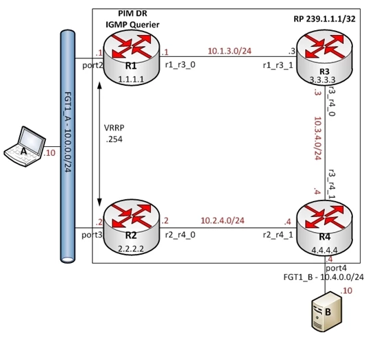

In the following diagram, B is the source sending multicast traffic toward group 239.1.1.1. R4 is the 1st hop router in charge of sending the PIM register message to the Rendezvous Point (RP). R3's Loopback (3.3.3.3) is the RP. All Multicast routers are configured with 3.3.3.3 as static RP address.
In this example, there was no receiver. The source registers first.
Once the source (B) starts sending multicast traffic toward 239.1.1.1, the Rendezvous Point (R3) should have a (10.4.0.10,239.1.1.1) entry in its multicast routing table.
