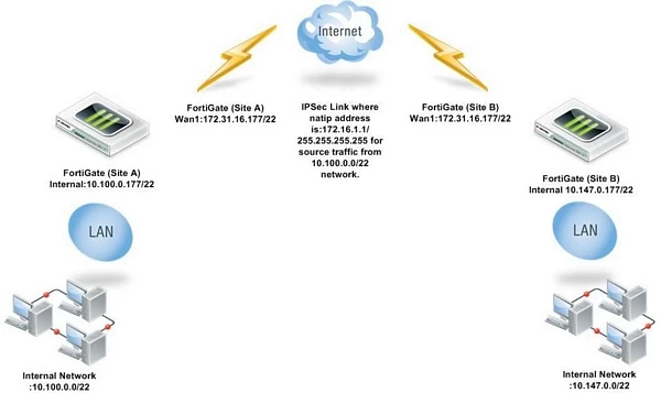

Scenario:
In this example two FortiGates in a site to site example will be used, where Site A will initiate an IPSec Policy Mode tunnel to Site B, and Site B will receive traffic from Site A with the “natip” address 172.16.1.1.

FortiGate 1 (Site A)
To NAT the traffic entering the IPSec tunnel with a specific IP address, a policy-mode IPSec tunnel can be created with the following configuration:
