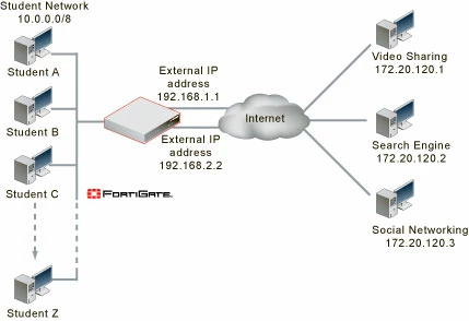

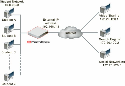

Consider the following idealized topology for a university that allows its students to connect to the Internet through a FortiGate unit:
Figure 1: Example university Internet connection topology
The university does not give a publicly routable IP address to its students. Instead each student uses DHCP to obtain an IP address from the 10.0.0.0/8 range from the FortiGate unit. The FortiGate unit then uses Network Address Port Translation (NAPT) to translate all traffic so that it appears to come from IP address 192.168.1.1.
For example, consider student A (IP address 10.78.33.97) who wants to connect to search engine (IP address 172.20.120.2) and sends a packet with the following IP addresses and port numbers:

Using a per NAT IP pool extends the approach further so that rather than just a per-protocol pool, the pool is also determined by the NAT IP. Thus, the pool is a function of the protocol and the NAT IP. In the topology shown in Figure 1 the NAT IP is 192.168.1.1. If there is only one NAT IP then this approach is no different from global per-protocol pools. However, consider the topology shown in Figure 2 with two separate Internet connections and thus two NAT IP addresses 192.168.1.1 and 192.168.2.2.
Figure 2: Example university Internet connection topology with two Internet connections:
If the FortiGate configuration includes equal-cost multipath (ECMP) routing, both Internet connections can be used simultaneously and the maximum number of connections is N*R*P where N is the number of NAT IP addresses, R is the port range, and P is the number of protocols. So for the case where there are two NAT IPs, the range is 60416 and the protocols are TCP and UDP then the maximum number of simultaneous connections is:
2*60416*2 = 241,664

Using the topology in Figure 1, for students simultaneously connecting to the search engine, the social networking and the video sharing sites on TCP port 80 then assuming each site uses one IP address a maximum of 60,416 simultaneous connections are allowed to each site or 60,416 * 3 = 181,248 connections in total.
