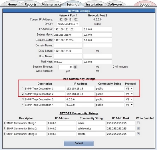

1) Configure the traps destination (Settings > Network).

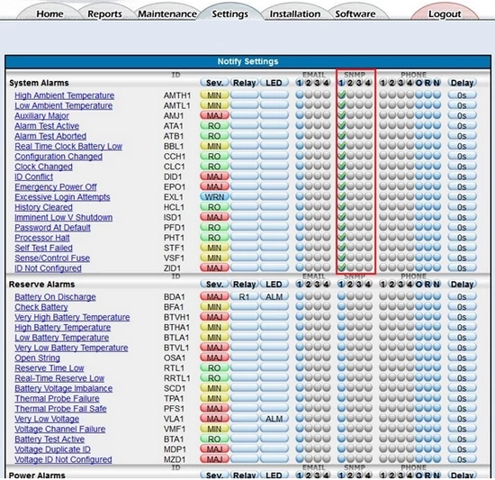

2) Assign alarm and events to specific SNMP destination (Settings > Alarm Notification).

SNMP Traps should go to the SNMP station.
