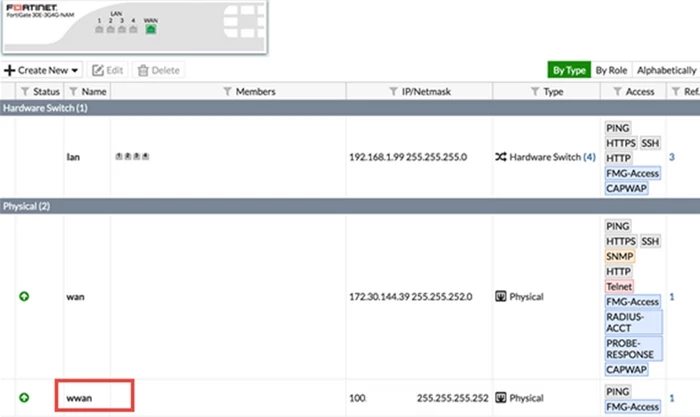

5) Check the status of the modem interface in the GUI. From the sidebar select System > Network > Interfaces.
The arrow next to the interface ‘wwan’ should be green and the IP address should be displayed.
