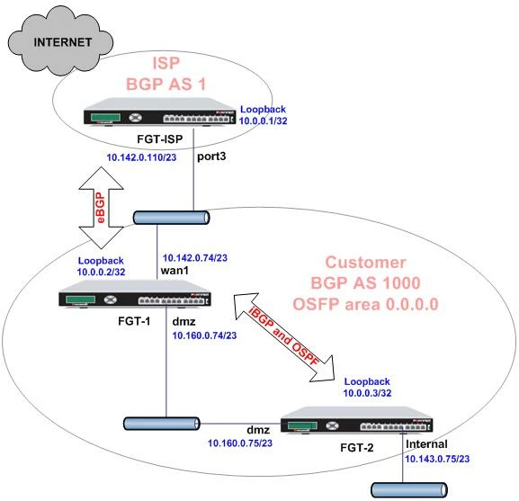

Diagram
The following network diagram illustrates this case study:
Expectations, Requirements
  •   FGT-ISP acts as the ISP router ; it advertises to FGT-1 all BGP routes it  does learn from the Internet (In this example, only 1.0.0.0/8 and 2.0.0.0/8 are used as routes advertised by the ISP).
  •   FGT-1 and FGT-2 learn all BGP routes advertised by the ISP’s router FGT-ISP.
  •   iBGP peering is done via loopback interfaces (*).
  •   The ISP should only learn the DMZ network from the Customer, 10.160.0.0/23.
  •   Customer uses OSPF as its IGP to advertise the loopback interface internally and allow BGP peering
Note: all requirements, addresses and network information above are only given as examples for this case study.

  • FGT-2
FGT-2 # get router info bgp summary
BGP router identifier 10.0.0.3, local AS number 1000
BGP table version is 1
2 BGP AS-PATH entries
0 BGP community entries
Neighbor        V    AS MsgRcvd MsgSent   TblVer  InQ OutQ Up/Down  State/PfxRcd
10.0.0.2        4  1000    4555    4563        0    0    0 2d18h28m        6
Total number of neighbors 1
FGT-2 # get router info bgp neighbors
BGP neighbor is 10.0.0.2, remote AS 1000, local AS 1000, internal link
  BGP version 4, remote router ID 10.0.0.2
  BGP state = Established, up for 2d18h28m
  Last read 00:00:06, hold time is 180, keepalive interval is 60 seconds
  Configured hold time is 180, keepalive interval is 60 seconds
  Neighbor capabilities:
    Route refresh: advertised and received (old and new)
    Address family IPv4 Unicast: advertised and received
  Received 4556 messages, 0 notifications, 0 in queue
  Sent 4563 messages, 0 notifications, 0 in queue
  Route refresh request: received 0, sent 0
  Minimum time between advertisement runs is 30 seconds
  Update source is loopback
 For address family: IPv4 Unicast
  BGP table version 1, neighbor version 0
  Index 1, Offset 0, Mask 0x2
  Community attribute sent to this neighbor (both)
  6 accepted prefixes
  0 announced prefixes
 Connections established 1; dropped 0
Local host: 10.0.0.3, Local port: 179
Foreign host: 10.0.0.2, Foreign port: 1101
Nexthop: 10.0.0.3
FGT-2 # get router info bgp network
BGP table version is 1, local router ID is 10.0.0.3
Status codes: s suppressed, d damped, h history, * valid, > best, i - internal,
              S Stale
Origin codes: i - IGP, e - EGP, ? - incomplete
   Network          Next Hop            Metric LocPrf Weight Path
*>i0.0.0.0/0        10.142.0.110             0    100      0 1 ?
*>i1.0.0.0          10.142.0.110             0    100      0 1 ?
*>i2.0.0.0          10.142.0.110             0    100      0 1 ?
*>i10.0.0.2/32      10.0.0.2                 0    100      0 ?
*>i10.142.0.0/23    10.0.0.2                 0    100      0 ?
*>i10.160.0.0/23    10.0.0.2                 0    100      0 ?
Total number of prefixes 6
FGT-2 # get router info ospf neighbor
OSPF process 0:
Neighbor ID     Pri   State           Dead Time   Address         Interface
10.0.0.2          1   Full/Backup     00:00:38    10.160.0.74     dmz
FGT-2 # get router info routing-table all
Codes: K - kernel, C - connected, S - static, R - RIP, B - BGP
       O - OSPF, IA - OSPF inter area
       N1 - OSPF NSSA external type 1, N2 - OSPF NSSA external type 2
       E1 - OSPF external type 1, E2 - OSPF external type 2
       i - IS-IS, L1 - IS-IS level-1, L2 - IS-IS level-2, ia - IS-IS inter area
       * - candidate default
B*      0.0.0.0/0 [200/0] via 10.142.0.110 (recursive via 10.160.0.74), 2d18h00m
B       1.0.0.0/8 [200/0] via 10.142.0.110 (recursive via 10.160.0.74), 2d18h00m
B       2.0.0.0/8 [200/0] via 10.142.0.110 (recursive via 10.160.0.74), 2d18h00m
O       10.0.0.2/32 [110/110] via 10.160.0.74, dmz, 2d18h20m
C       10.0.0.3/32 is directly connected, loopback
O       10.142.0.0/23 [110/20] via 10.160.0.74, dmz, 2d18h20m
C       10.143.0.0/23 is directly connected, internal
C       10.160.0.0/23 is directly connected, dmz
