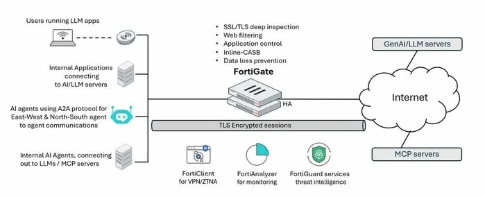

Introduction:
With an increase in use of Artificial Intelligence-related applications by various types of users within campus networks like LLM apps, AI agents, MCP clients, etc, IT teams would be expected to ensure the implementation of security control policies to selectively filter and monitor this new type of application traffic.
In this article, some of the most common use cases to implement such security controls are discussed and illustrated with examples, starting with something as simple as detecting and blocking all AI/LLM traffic, to more complex use cases of detecting sensitive keywords used in LLM prompts and using custom HTTP header tags to allow internally sanitized and approved AI/LLM traffic. A combination of these security controls can be used to achieve additional use cases. Client applications accessing these AL/LLM traffic could come from corporate workstations using LLM apps (maybe shadow IT), AI agents hosted on the internal networks, VPN clients (FortiClient), LLM apps on BYOD devices, etc.

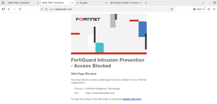

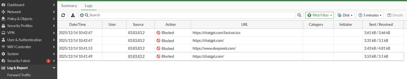

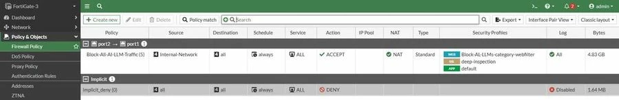

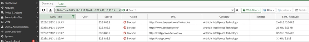

Use case 1: Block all AI/LLM traffic egressing the network - using FortiGuard category-based web filtering:
To start with, this is the basic use case, wherein the security control requirement is to identify and block all the known AI/LLM category of websites/applications, whether originating from a particular segment of the internal network or from all internal network. Below is an illustration of how this can be done on the FortiGate, using the new 'Artificial Intelligence Technology' FortiGuard webfilter category (assigned category number is 100).
FortiGate # get webfilter categories | grep "Artificial Intelligence"     100 Artificial Intelligence Technology FortiGate # ​
Configuration examples using this new category to implement a firewall policy to block AL/LLM traffic are shown below.
FortiGate# config webfilter profile  edit "Block-AL-LLMs-category-webfilter"         config ftgd-wf             unset options             config filters                 edit 1                     set category 1                 next                 edit 2                     set category 3                 next                 . . .                 edit 33                     set category 91                     set action block                 next                 edit 34                     set category 100                      set action block  <<<<<<<<<<<<< Blocking AI category                 next             end         end     next end  FortiGate# show firewall policy config firewall policy     edit 3         set name "Block-All-AI-LLM-Traffic"         set uuid fac30b06-d856-51f0-2043-2641cb12d949         set srcintf "port2"         set dstintf "port1"         set action accept         set srcaddr "Internal-Network"         set dstaddr "all"         set schedule "always"         set service "ALL"         set utm-status enable         set inspection-mode proxy         set ssl-ssh-profile "deep-inspection"         set webfilter-profile "Block-AL-LLMs-category-webfilter"         set application-list "default"         set logtraffic all         set logtraffic-start enable         set nat enable     next end

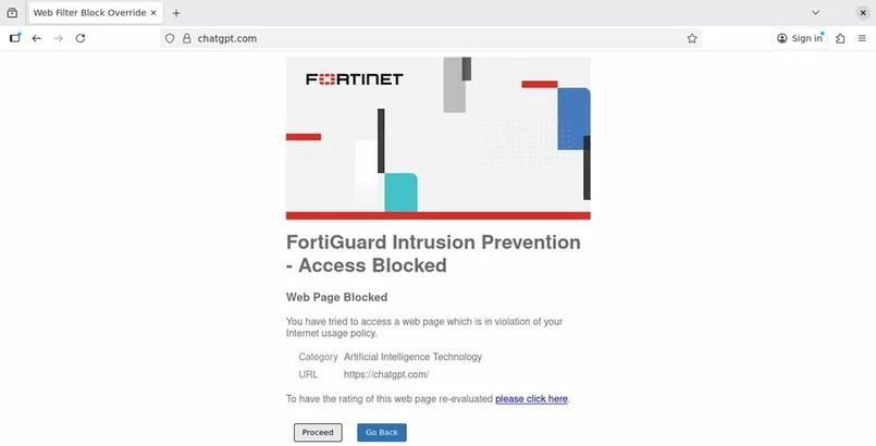

When an internal user tries to access an AI/LLM site, the access is blocked with the following error message (the error message can be customized as well).
FortiGate will record this blocked event in the logs as shown below.
date=2025-12-13 time=11:14:49 eventtime=1765653288986595175 tz="-0800" logid="0316013056" type="utm" subtype="webfilter" eventtype="ftgd_blk" level="warning" vd="root" policyid=3 poluuid="fac30b06-d856-51f0-2043-2641cb12d949" policytype="policy" sessionid=96576 srcip=192.168.20.1 srcport=55670 srccountry="Netherlands" srcintf="port2" srcintfrole="undefined" srcuuid="d79843d6-d855-51f0-4627-b903d4525d2b" dstip=A.B.C.D dstport=443 dstcountry="United States" dstintf="port1" dstintfrole="undefined" dstuuid="8486dec2-d7b1-51f0-88ae-be591ae2a2fe" proto=6 httpmethod="GET" service="HTTPS" hostname="www.deepseek.com " agent="Mozilla/5.0 (X11; Ubuntu; Linux x86_64; rv:143.0) Gecko/20100101" profile="Block-AL-LLMs-category-webfilter" action="blocked" reqtype="direct" url="https://www.deepseek.com/ " sentbyte=2505 rcvdbyte=5082 direction="outgoing" msg="URL belongs to a denied category in policy" ratemethod="domain" cat=100 catdesc="Artificial Intelligence Technology"
date=2025-12-13 time=11:13:46 eventtime=1765653227133832451 tz="-0800" logid="0316013056" type="utm" subtype="webfilter" eventtype="ftgd_blk" level="warning" vd="root" policyid=3 poluuid="fac30b06-d856-51f0-2043-2641cb12d949" policytype="policy" sessionid=94101 srcip=192.168.20.1 srcport=35840 srccountry="Netherlands" srcintf="port2" srcintfrole="undefined" srcuuid="d79843d6-d855-51f0-4627-b903d4525d2b" dstip=A.B.C.D dstport=443 dstcountry="United States" dstintf="port1" dstintfrole="undefined" dstuuid="8486dec2-d7b1-51f0-88ae-be591ae2a2fe" proto=6 httpmethod="GET" service="HTTPS" hostname="chatgpt.com" agent="Mozilla/5.0 (X11; Ubuntu; Linux x86_64; rv:143.0) Gecko/20100101" profile="Block-AL-LLMs-category-webfilter" action="blocked" reqtype="direct" url="https://chatgpt.com/ " sentbyte=3304 rcvdbyte=3103 direction="outgoing" msg="URL belongs to a denied category in policy" ratemethod="domain" cat=100 catdesc="Artificial Intelligence Technology"
These logs can be used for monitoring the AI/LLM application traffic in the network using either the 'Log & Report' section of egress FortiGates, or with a FortiAnalyzer for an aggregated & comprehensive view of the application traffic across multiple campuses & remote sites of the company.

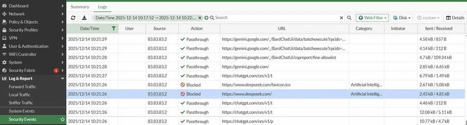

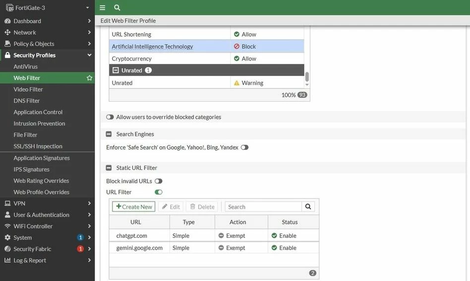

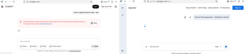

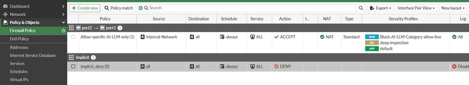

Use case 2: Allow only specific AI/LLM traffic - using static URL filter & FortiGuard category web-filter:
If the requirement is to allow a few IT-approved AI/LLM applications and block all the other AI/LLM traffic, this can be implemented with a static URL filter specifying explicitly the FQDNs of the apps that are to be allowed, and blocking the remaining AI/LLM category traffic. The static URL filter takes precedence over the Category filter on the FortiGate and thus enables this use case. Here is a configuration example of how to implement this.
FortiGate # show webfilter urlfilter  config webfilter urlfilter     edit 2         set name "Auto-webfilter-urlfilter_cvwof7u3n"         config entries             edit 1                 set url "chatgpt.com"             next             edit 2                 set url "gemini.google.com"             next         end     next end FortiGate # show webfilter profile Block-AI-LLM-Category-allow-few  config webfilter profile     edit "Block-AI-LLM-Category-allow-few"         config web             set urlfilter-table 2         end         config ftgd-wf             config filters                 edit 1                     set category 1                 next                 edit 2                     set category 3                 next                 . . .                 edit 34                     set category 100                     set action block                 next             end         end     next end FortiGate #  config firewall policy Challenger-kvm47 (policy) # edit "1" Challenger-kvm47 (1) # show config firewall policy     edit 1         set name "Allow-specific-AI-LLM-only"         set uuid 1fef53c4-d917-51f0-21db-6c30e158d0fb         set srcintf "port2"         set dstintf "port1"         set action accept         set srcaddr "Internal-Network"         set dstaddr "all"         set schedule "always"         set service "ALL"         set utm-status enable         set inspection-mode proxy         set ssl-ssh-profile "deep-inspection"         set webfilter-profile "Block-AI-LLM-Category-allow-few"         set application-list "default"         set logtraffic all         set logtraffic-start enable         set nat enable     next end FortiGate #
Static URL filter definition to allow selected URLs, and the 'Artificial Intelligence Technology' category set to Block using FortiGate GUI.
An example of an error log illustrating the configuration taking effect. Traffic to one of the AI/LLM servers is blocked, which is not defined in the static URL, while the other AI/LLM server access is allowed through 'passthrough' mode.
FortiGate# execute log display
date=2025-12-14 time=10:21:28 eventtime=1765736488021454238 tz="-0800" logid="0315012545" type="utm" subtype="webfilter" eventtype="urlfilter" level="information" vd="root" urlfilteridx=2 urlfilterlist="Auto-webfilter-urlfilter_cvwof7u3n" policyid=1 poluuid="1fef53c4-d917-51f0-21db-6c30e158d0fb" policytype="policy" sessionid=1144528 srcip=192.168.20.1 srcport=60090 srccountry="Netherlands" srcintf="port2" srcintfrole="undefined" srcuuid="d79843d6-d855-51f0-4627-b903d4525d2b" dstip=A.B.C.D dstport=443 dstcountry="Canada" dstintf="port1" dstintfrole="undefined" dstuuid="8486dec2-d7b1-51f0-88ae-be591ae2a2fe" proto=6 httpmethod="GET" service="HTTPS" hostname="gemini.google.com" agent="Mozilla/5.0 (X11; Ubuntu; Linux x86_64; rv:143.0) Gecko/20100101" profile="Block-AI-LLM-Category-allow-few" action="passthrough" reqtype="direct" url="https://gemini.google.com/ " sentbyte=2850 rcvdbyte=6647 direction="outgoing" msg="URL was exempted because it is in the URL filter list"
date=2025-12-14 time=10:21:27 eventtime=1765736487583027473 tz="-0800" logid="0315012545" type="utm" subtype="webfilter" eventtype="urlfilter" level="information" vd="root" urlfilteridx=1 urlfilterlist="Auto-webfilter-urlfilter_cvwof7u3n" policyid=1 poluuid="1fef53c4-d917-51f0-21db-6c30e158d0fb" policytype="policy" sessionid=1144511 srcip=192.168.20.1 srcport=47030 srccountry="Netherlands" srcintf="port2" srcintfrole="undefined" srcuuid="d79843d6-d855-51f0-4627-b903d4525d2b" dstip=A.B.C.D dstport=443 dstcountry="United States" dstintf="port1" dstintfrole="undefined" dstuuid="8486dec2-d7b1-51f0-88ae-be591ae2a2fe" proto=6 httpmethod="POST" service="HTTPS" hostname="chatgpt.com" agent="Mozilla/5.0 (X11; Ubuntu; Linux x86_64; rv:143.0) Gecko/20100101" profile="Block-AI-LLM-Category-allow-few" action="passthrough" reqtype="referral" url="https://chatgpt.com/ces/v1/t " referralurl="https://chatgpt.com/ " sentbyte=6789 rcvdbyte=1489 direction="outgoing" msg="URL was exempted because it is in the URL filter list"
date=2025-12-14 time=10:21:26 eventtime=1765736486296681436 tz="-0800" logid="0316013056" type="utm" subtype="webfilter" eventtype="ftgd_blk" level="warning" vd="root" policyid=1 poluuid="1fef53c4-d917-51f0-21db-6c30e158d0fb" policytype="policy" sessionid=1144519 srcip=192.168.20.1 srcport=56478 srccountry="Netherlands" srcintf="port2" srcintfrole="undefined" srcuuid="d79843d6-d855-51f0-4627-b903d4525d2b" dstip=A.B.C.D dstport=443 dstcountry="United States" dstintf="port1" dstintfrole="undefined" dstuuid="8486dec2-d7b1-51f0-88ae-be591ae2a2fe" proto=6 httpmethod="GET" service="HTTPS" hostname="www.deepseek.com " agent="Mozilla/5.0 (X11; Ubuntu; Linux x86_64; rv:143.0) Gecko/20100101" profile="Block-AI-LLM-Category-allow-few" action="blocked" reqtype="direct" url="https://www.deepseek.com/ " sentbyte=2433 rcvdbyte=4810 direction="outgoing" msg="URL belongs to a denied category in policy" ratemethod="domain" cat=100 catdesc="Artificial Intelligence Technology"
Alternatively, two separate firewall policies can be used for this use case - first one to allow specific LLM FQDNs as dstaddr and service 'HTTPS' or 'ALL', and the second policy with a webfilter to block FortiGuard category 'Artificial Intelligence Technology'.

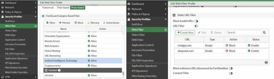

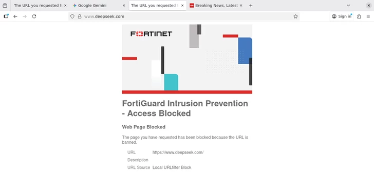

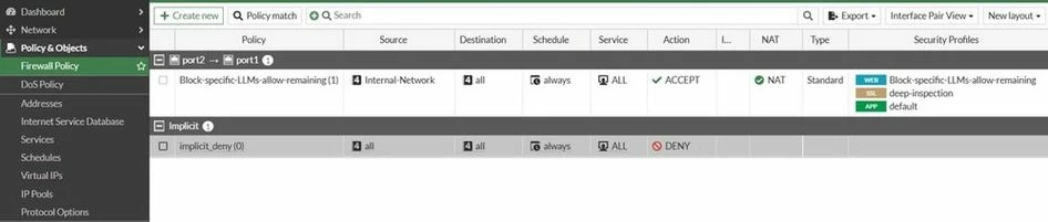

Use case 3: Block specific AI/LLM traffic - using static URL filter and FortiGuard category based web-filter.
This use case is an inverse of the previous use case, wherein the requirement is to block certain AI/LLM traffic and allow the others. This can be achieved again by using the combination of static filters and FortiGuard category-based filters, as shown below. Explicitly define the URLs that are to be blocked in the static filters, and then set the policy to allow in the AI category.
FortiGate # show webfilter urlfilter  config webfilter urlfilter     edit 1         set name "Auto-webfilter-urlfilter_uzyxsa8ai"         config entries             edit 1                 set url "chatgpt.com"                 set action block             next             edit 2                 set url "deepseek.com"                 set action block             next         end     next FortiGate # show webfilter profile Block-specific-LLMs-allow-remaining  config webfilter profile     edit "Block-specific-LLMs-allow-remaining"         set feature-set proxy         config web             set urlfilter-table 1         end         config ftgd-wf             set exempt-quota g21             config filters                 edit 1                     set category 1                 next                 edit 2                     set category 3                 next                 . . .                 edit 35                     set category 100                     set action allow                 next             end         end     next end FortiGate # config firewall policy FortiGate (policy) # edit "1" FortiGate # show config firewall policy     edit 1         set name "Block-specific-LLMs-allow-remaining"         set uuid 1fef53c4-d917-51f0-21db-6c30e158d0fb         set srcintf "port2"         set dstintf "port1"         set action accept         set srcaddr "Internal-Network"         set dstaddr "all"         set schedule "always"         set service "ALL"         set utm-status enable         set inspection-mode proxy         set ssl-ssh-profile "deep-inspection"         set webfilter-profile "Block-specific-LLMs-allow-remaining"         set application-list "default"         set logtraffic all         set logtraffic-start enable         set nat enable     next end FortiGate #
An internal user trying to access the AI/LLM server that is restricted in the firewall policy will get the following error message:
The block event will be recorded in the logs as shown below.
date=2025-12-14 time=10:41:53 eventtime=1765737712580014808 tz="-0800" logid="0315012544" type="utm" subtype="webfilter" eventtype="urlfilter" level="warning" vd="root" urlfilteridx=2 urlfilterlist="Auto-webfilter-urlfilter_uzyxsa8ai" policyid=1 poluuid="1fef53c4-d917-51f0-21db-6c30e158d0fb" policytype="policy" sessionid=1161805 srcip=192.168.20.1 srcport=45588 srccountry="Netherlands" srcintf="port2" srcintfrole="undefined" srcuuid="d79843d6-d855-51f0-4627-b903d4525d2b" dstip=A.B.C.D dstport=443 dstcountry="United States" dstintf="port1" dstintfrole="undefined" dstuuid="8486dec2-d7b1-51f0-88ae-be591ae2a2fe" proto=6 httpmethod="GET" service="HTTPS" hostname="www.deepseek.com " agent="Mozilla/5.0 (X11; Ubuntu; Linux x86_64; rv:143.0) Gecko/20100101" profile="Block-specific-LLMs-allow-remaining" action="blocked" reqtype="direct" url="https://www.deepseek.com/ " sentbyte=2433 rcvdbyte=4810 direction="outgoing" urlsource="Local URLfilter Block" msg="URL was blocked because it is in the URL filter list" crscore=30 craction=8 crlevel="high"

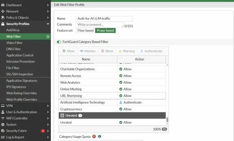

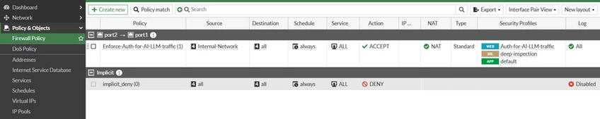

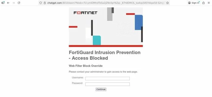

Use case 4: Force authenticate users accessing AI/LLM applications - using firewall policies.
In this use case, IT might want to implement security control by adding explicit authentication for users accessing these applications, thereby limiting access to a subset of internal users, and expanding as needed. This can be done by adding the 'authenticate' action in the FortiGuard category-based filter for category 100, as shown in the example below.
FortiGate # show webfilter profile Auth-for-AI-LLM-traffic  config webfilter profile     edit "Auth-for-AI-LLM-traffic"         set feature-set proxy         config ftgd-wf             config filters                 edit 1                     set category 1                 next                 edit 2                     set category 3                 next                 . . .                 edit 34                     set category 100                     set action authenticate                     set auth-usr-grp "Internal-Users"                 next             end         end     next end  FortiGate # config firewall policy FortiGate (policy) # edit "1" FortiGate (1) # show config firewall policy     edit 1         set name "Enforce-Auth-for-AI-LLM-traffic"         set uuid 1fef53c4-d917-51f0-21db-6c30e158d0fb         set srcintf "port2"         set dstintf "port1"         set action accept         set srcaddr "Internal-Network"         set dstaddr "all"         set schedule "always"         set service "ALL"         set utm-status enable         set inspection-mode proxy         set ssl-ssh-profile "deep-inspection"         set webfilter-profile "Auth-for-AI-LLM-traffic"         set application-list "default"         set logtraffic all         set logtraffic-start enable         set nat enable     next end FortiGate #
The action is set to 'Authenticate' specifically for the AI category, and allows/blocks for other categories.
The user will see the warning below when trying to access an AI/LLM server. After selecting 'proceed', the user will see an option to provide authentication credentials to access the server.
Once authentication succeeds, the user will see access to the website as shown in the example below.
Log entries corresponding to the initial block event, and then the subsequent passthrough actions after the user authenticates, are recorded in the FortiGate as shown below:
date=2025-12-14 time=10:58:21 eventtime=1765738701673735411 tz="-0800" logid="0316013057" type="utm" subtype="webfilter" eventtype="ftgd_blk" level="warning" vd="root" policyid=1 poluuid="1fef53c4-d917-51f0-21db-6c30e158d0fb" policytype="policy" sessionid=1176900 srcip=192.168.20.1 srcport=36654 srccountry="Netherlands" srcintf="port2" srcintfrole="undefined" srcuuid="d79843d6-d855-51f0-4627-b903d4525d2b" dstip=A.B.C.D dstport=443 dstcountry="United States" dstintf="port1" dstintfrole="undefined" dstuuid="8486dec2-d7b1-51f0-88ae-be591ae2a2fe" proto=6 httpmethod="GET" service="HTTPS" hostname="chatgpt.com" agent="Mozilla/5.0 (X11; Ubuntu; Linux x86_64; rv:143.0) Gecko/20100101" profile="Auth-for-AI-LLM-traffic" action="passthrough" reqtype="referral" url="https://chatgpt.com/ces/v1/projects/oai/settings " referralurl="https://chatgpt.com/ " sentbyte=4829 rcvdbyte=72407 direction="outgoing" msg="URL belongs to a category with warnings enabled" ratemethod="domain" cat=100 catdesc="Artificial Intelligence Technology"
date=2025-12-14 time=10:58:20 eventtime=1765738700919081459 tz="-0800" logid="0316013057" type="utm" subtype="webfilter" eventtype="ftgd_blk" level="warning" vd="root" policyid=1 poluuid="1fef53c4-d917-51f0-21db-6c30e158d0fb" policytype="policy" sessionid=1176900 srcip=192.168.20.1 srcport=36654 srccountry="Netherlands" srcintf="port2" srcintfrole="undefined" srcuuid="d79843d6-d855-51f0-4627-b903d4525d2b" dstip=A.B.C.D dstport=443 dstcountry="United States" dstintf="port1" dstintfrole="undefined" dstuuid="8486dec2-d7b1-51f0-88ae-be591ae2a2fe" proto=6 httpmethod="GET" service="HTTPS" hostname="chatgpt.com" agent="Mozilla/5.0 (X11; Ubuntu; Linux x86_64; rv:143.0) Gecko/20100101" profile="Auth-for-AI-LLM-traffic" action="passthrough" reqtype="referral" url="https://chatgpt.com/ " referralurl="https://chatgpt.com:8010/ " sentbyte=3466 rcvdbyte=3662 direction="outgoing" msg="URL belongs to a category with warnings enabled" ratemethod="domain" cat=100 catdesc="Artificial Intelligence Technology"
date=2025-12-14 time=10:57:30 eventtime=1765738650911606768 tz="-0800" logid="0316013057" type="utm" subtype="webfilter" eventtype="ftgd_blk" level="warning" vd="root" policyid=1 poluuid="1fef53c4-d917-51f0-21db-6c30e158d0fb" policytype="policy" sessionid=1176900 srcip=192.168.20.1 srcport=36654 srccountry="Netherlands" srcintf="port2" srcintfrole="undefined" srcuuid="d79843d6-d855-51f0-4627-b903d4525d2b" dstip=A.B.C.D dstport=443 dstcountry="United States" dstintf="port1" dstintfrole="undefined" dstuuid="8486dec2-d7b1-51f0-88ae-be591ae2a2fe" proto=6 httpmethod="GET" service="HTTPS" hostname="chatgpt.com" agent="Mozilla/5.0 (X11; Ubuntu; Linux x86_64; rv:143.0) Gecko/20100101" profile="Auth-for-AI-LLM-traffic" action="blocked" reqtype="direct" url="https://chatgpt.com/ " sentbyte=3336 rcvdbyte=3662 direction="outgoing" msg="URL belongs to a category with warnings enabled" ratemethod="domain" cat=100 catdesc="Artificial Intelligence Technology"

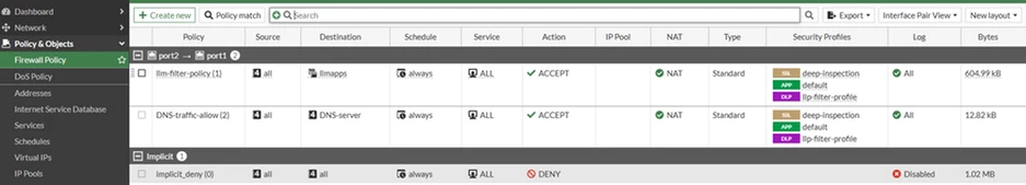

Use case 5: Detect and block sensitive keywords in the LLM chat/conversations - using DLP on FortiGate.
If the requirement is to detect certain sensitive keywords and block those keywords, prompts containing those keywords from reaching the AI/LLM applications, then this can be done using DLP on FortiGate. This could be used as one of the methods to do Input Validation against prompt injection attacks, wherein FortiGate DLP can look for suspicious prompt keywords like 'ignore previous instructions', PII, 'API key', standard system prompts, etc.
To get started, first define the list of sensitive keywords in the DLP dictionary, like as example source code, secret, confidential, or any internal project names, etc. There are several other data types that are supported in the FortiGate DLP dictionary, as shown in the config example below.
FortiGate # config dlp dictionary  FortiGate  (dictionary) # edit llm-filter  FortiGate  (llm-filter) # config entries  FortiGate  (entries) # edit 4 FortiGate  (4) # set type ? <string>    please input string value "credit-card"     data-type "edm-keyword"     data-type "hex"             data-type "keyword"         data-type "regex"           data-type "ssn-us"          data-type FortiGate  (4) #
In this example, the concerned sensitive keywords are listed in the DLP dictionary that the DLP sensor will scan for. Next, define a DLP profile with the policy to block the messages containing the sensitive keywords, and finally map the profile to the firewall policy for the AI/LLM applications of interest.
FortiGate # show dlp dictionary config dlp dictionary     edit "llm-filter"         set uuid 3fd30af4-d84b-51f0-4e45-8a62eec945b8         config entries             edit 1                 set type "keyword"                 set pattern "source code"                 set ignore-case enable             next             edit 2                 set type "keyword"                 set pattern "password"                 set ignore-case enable             next             edit 3                 set type "keyword"                 set pattern "API key"                 set ignore-case enable             next             edit 4                 set type "keyword"                 set pattern "ignore previous instructions"                 set ignore-case enable             next         end     next end FortiGate # show dlp sensor  config dlp sensor     edit "dlp-filter-sensor"         config entries             edit 1                 set dictionary "llm-filter"             next         end     next end  FortiGate # show dlp profile  config dlp profile     edit "default"         set comment "Default profile."     next     edit "sniffer-profile"         set comment "Log a summary of email and web traffic."         set summary-proto smtp pop3 imap http-get http-post     next     edit "dlp-filter-profile"         set feature-set proxy         config rule             edit 1                 set name "llm-filter-1"                 set severity critical                 set proto http-post                 set filter-by sensor                 set sensor "dlp-filter-sensor"                 set action block             next             edit 2                 set name "llm-filter-2"                 set type message                 set proto http-post                 set filter-by sensor                 set sensor "dlp-filter-sensor"                 set action block             next         end     next end  FortiGate # show firewall address config firewall address     edit "1"         set uuid 4aeb4c16-d84c-51f0-c35c-342d8df71a39         set type fqdn         set fqdn "chatgpt.com"     next     edit "2"         set uuid bb47a146-d87c-51f0-c9f6-defff1099e9d         set type fqdn         set fqdn "deepseek.com"     next     edit "3"         set uuid 57339582-d84c-51f0-b00d-e7662623e740         set type fqdn         set fqdn "gemini.google.com"     next end FortiGate #  show firewall addrgrp config firewall addrgrp     edit "llmapps"         set uuid 77a057f6-d84c-51f0-5cec-6d8bef41e5f5         set member "1" "2" "3"     next end  FortiGate # show firewall policy 1 config firewall policy     edit 1         set name "llm-filter-policy"         set uuid 88f93fc2-d84c-51f0-34ae-03c3446f3e17         set srcintf "port2"         set dstintf "port1"         set action accept         set srcaddr "all"         set dstaddr "llmapps"         set schedule "always"         set service "ALL"         set utm-status enable         set inspection-mode proxy         set ssl-ssh-profile "deep-inspection"         set dlp-profile "dlp-filter-profile"         set application-list "default"         set logtraffic all         set logtraffic-start enable         set nat enable     next end FortiGate #
During the user's conversation with an AI/LLM application, if the user inputs a prompt containing sensitive keywords, that message is blocked by the FortiGate, and an error similar to the following is shown to the user.
A log entry corresponding to the DLP event is also recorded in the FortiGate, as shown in the examples below.

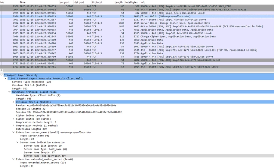

Use case 7: Model Context Protocol (MCP) traffic filtering - using FortiGate SSL deep inspection.
Model Context Protocol (MCP) is an open standard protocol that allows AI Agents to connect to external tools, data sources, APIs, etc. Depending on the security control objectives on the network, controlling MCP traffic egressing/ingressing the network might be necessary. MCP uses JSON-RPC messages in a client-server model, over standard TLS-encrypted HTTPS. So, one way to filter MCP traffic is to create a list of MCP FQDNs of interest as firewall address objects, enable SSL deep inspection and then block/allow traffic to those MCP servers depending on the requirements. Here is an example wireshark capture of an MCP client to server communication, over TLS-encrypted HTTPS.
More details about MCP are available in the Model Context Protocol Architecture overview.

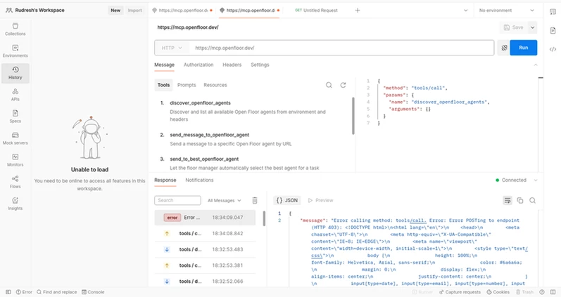

The following is a configuration example to illustrate how this can be implemented. MCP servers typically contain the keyword 'mcp' in the URL to make it clear for the client application that the said URL maps specifically to the MCP server of that site. A few commonly used MCP server URL examples are shown below:
https://day.ai/api/mcp
https://huggingface.co/mcp
https://mcp-server.egnyte.com/mcp

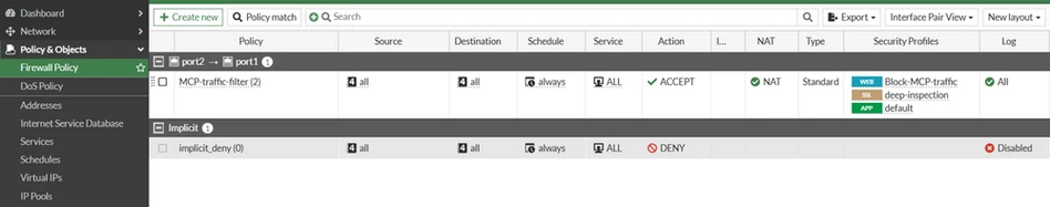

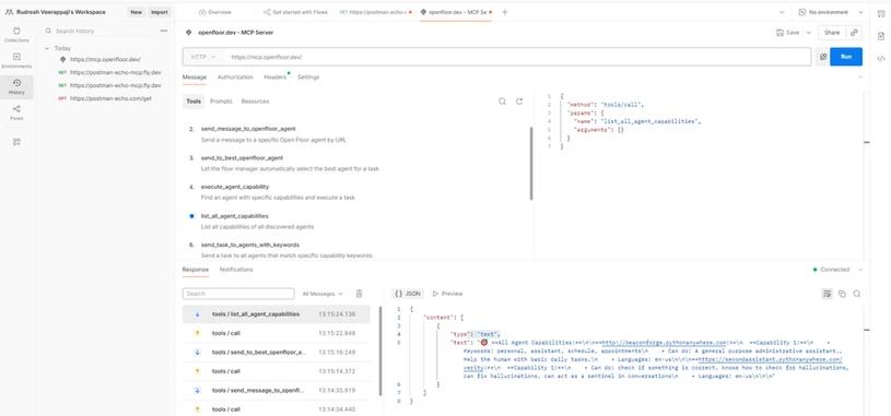

The following is an example to illustrate a client (Postman as an example) testing access to an MCP server by making a tool/call to query list_all_agent_capabilities. This traffic is allowed before the implementation of the firewall policy, and the response is also received by the client, with the list of agent capabilities as shown below.
To filter the MCP traffic, start by defining a static URL filter with a regex to match URLs containing the keyword 'mcp', with the action set to block. Enable SSL deep inspection in the firewall policy and attach the webfilter profile.
FortiGate # show webfilter urlfilter 3 config webfilter urlfilter     edit 3         set name "Auto-webfilter-urlfilter_787s17ejx"         config entries             edit 1                 set url ".*mcp.*"                 set type regex                 set action block             next         end     next end FortiGate # show webfilter profile Block-MCP-traffic  config webfilter profile     edit "Block-MCP-traffic"         set feature-set proxy         config web             set urlfilter-table 3         end         config ftgd-wf             config filters                 edit 1                     set category 1                 next                 edit 2                     set category 3                 . . .                 next             end         end     next end FortiGate # config firewall policy FortiGate (policy) # edit "2" FortiGate (2) # show config firewall policy     edit 2         set name "MCP-traffic-filter"         set uuid 94be9c32-d9df-51f0-2dbd-d2d7a7a52559         set srcintf "port2"         set dstintf "port1"         set action accept         set srcaddr "all"         set dstaddr "all"         set schedule "always"         set service "ALL"         set utm-status enable         set inspection-mode proxy         set ssl-ssh-profile "deep-inspection"         set webfilter-profile "Block-MCP-traffic"         set application-list "default"         set logtraffic all         set logtraffic-start enable         set nat enable     next end FortiGate #
The client (using the Postman app as an example) is now blocked from access to the same MCP server, due to the configured firewall policy. Postman MCP client returns with an error indicating an issue with the calling method - 'Error POSTing to endpoint (HTTP 403)'.
A log entry corresponding to the block event is also recorded in the FortiGate, as shown below.
date=2025-12-15 time=10:34:09 eventtime=1765823649260560680 tz="-0800" logid="0315012544" type="utm" subtype="webfilter" eventtype="urlfilter" level="warning" vd="root" urlfilteridx=1 urlfilterlist="Auto-webfilter-urlfilter_787s17ejx" policyid=2 poluuid="94be9c32-d9df-51f0-2dbd-d2d7a7a52559" policytype="policy" sessionid=2287299 srcip=192.168.20.1 srcport=34632 srccountry="Netherlands" srcintf="port2" srcintfrole="undefined" srcuuid="8486dec2-d7b1-51f0-88ae-be591ae2a2fe" dstip=A.B.C.D dstport=443 dstcountry="Germany" dstintf="port1" dstintfrole="undefined" dstuuid="8486dec2-d7b1-51f0-88ae-be591ae2a2fe" proto=6 httpmethod="POST" service="HTTPS" hostname="mcp.openfloor.dev" agent="PostmanClient/11.76.1 (AppId=bb6ea6d4-4e3e-4814-9f5e-09695765684" profile="Block-MCP-traffic" action="blocked" reqtype="direct" url="https://mcp.openfloor.dev/ " sentbyte=1212 rcvdbyte=260 direction="outgoing" urlsource="Local URLfilter Block" msg="URL was blocked because it is in the URL filter list" crscore=30 craction=8 crlevel="high"

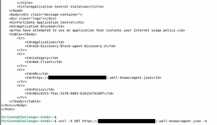

To filter this A2A traffic at the first step itself, look for the 'well-known/agent.json' or 'well-known/agent-card.json' pattern in the GET requests and block/allow those sessions depending on the requirements. Below is an example configuration on FortiGate which will recognize & block the agent discovery messages, so that no further A2A communication takes place. This is an example using application control with custom signature in a firewall policy with SSL deep inspection, but can be done with webfilter as well as shown in the later section.
FortiGate # show application custom config application custom     edit "A2A-Discovery-Block-agent-discovery-part-1"         set comment ''         set signature "F-SBID( --attack_id 6777; --name \"A2A-Discovery-Block-agent-discovery-part1\"; --service HTTP; --protocol tcp; --app_cat 25; --flow from_client; --pattern \".well-known/agent.json\"; --no_case; --context uri; --weight 40; )"         set category 25     next     edit "A2A-Discovery-Block-agent-discovery-part-2"         set comment ''         set signature "F-SBID( --attack_id 6778; --name \"A2A-Discovery-Block-agent-discovery-part2\"; --service HTTP; --protocol tcp; --app_cat 25; --flow from_client; --pattern \".well-known/agent-card.json\"; --no_case; --context uri; --weight 40; )"         set category 25     next end config application list     edit "Application-control-NGFW"         set other-application-log enable         config entries             edit 1                 set application 6777             next             edit 2                 set application 6778             next             edit 3                 set category 2 6             next         end     next end config firewall policy     edit 2         set name "A2A-traffic-filter"         set uuid 881c6372-f5ac-51f0-9d83-616152f41d9f         set srcintf "port2"         set dstintf "port1"         set action accept         set srcaddr "Internal-Network"         set dstaddr "all"         set schedule "always"         set service "ALL"         set utm-status enable         set inspection-mode proxy         set ssl-ssh-profile "deep-inspection"         set application-list "Application-control-NGFW"         set logtraffic all         set nat enable     next end
Additionally, the following is an example with webfilter that can be used to detect and block A2A traffic instead of application control, for reference:

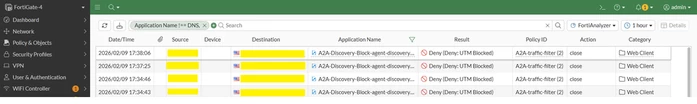

With the application control configurations applied on the FortiGate, a client agent on the internal network trying to perform an Agent discovery with a server on the untrusted network in the egress will be shown a block message. An example of an agent discovery call like this with a simple cURL command is illustrated below.
Linux:~$ curl -X GET https://example.com/.well-known/agent.json -k
Log entries corresponding to this event is also recorded in the FortiGate (check both 'Forward traffic logs' and 'Security Events' for detailed logs showing app control matches), as shown in the examples below.
date=2026-02-09 time=17:38:06 id=7604998449569726466 itime="2026-02-09 17:38:04" euid=3 epid=101 dsteuid=3 dstepid=101 logflag=3 logver=706063652 type="traffic" subtype="forward" level="notice" action="close" utmaction="block" policyid=2 sessionid=2363520 srcip=192.168.20.1 dstip=A.B.C.D transip=10.0.0.26 srcport=33746 dstport=443 transport=33746 trandisp="snat" duration=1 proto=6 sentbyte=1140 rcvdbyte=41090 sentpkt=11 rcvdpkt=36 logid=0000000013 service="HTTPS" app="A2A-Discovery-Block-agent-discovery" appcat="Web.Client" srcintfrole="undefined" dstintfrole="undefined" appid=6777 policytype="policy" eventtime=1770676685818573521 wanin=3412 wanout=560 lanin=938 lanout=39210 countapp=3 poluuid="881c6372-f5ac-51f0-9d83-616152f41d9f" srccountry="Netherlands" dstcountry="United States" srcintf="port2" dstintf="port1" applist="Application-control-NGFW" policyname="A2A-traffic-filter" hostname="example.com" saasinfo=1,0,0 apps=A2A-Discovery-Block-agent-discovery-2,SSL_TLSv1.3,SSL tz="-0500" srccity="Sudwest-Fryslan" srcgeoid=2748714 dstgeoid=6252001 devid="FGVMULTM25000026" vd="root" utmref="BAYAAAAMAAAByBAAAAMthimnLYYppcgMAAADLYYppy2GKaXICAAAAy2GKacthimk=" dtime="2026-02-09 17:38:06" itime_t=1770676684 devname="FortiGate-4"
date=2026-02-09 time=17:38:05 id=7604998445274759172 itime="2026-02-09 17:38:03" euid=3 epid=101 dsteuid=3 dstepid=101 logflag=0 logver=706063652 type="utm" subtype="app-ctrl" level="warning" action="block" sessionid=2363520 policyid=2 srcip=192.168.20.1 dstip=A.B.C.D srcport=33746 dstport=443 proto=6 logid=1059028705 service="HTTPS" eventtime=1770676684722711098 incidentserialno=179361819 direction="outgoing" appid=6777 srcintfrole="undefined" dstintfrole="undefined" applist="Application-control-NGFW" appcat="Web.Client" app="A2A-Discovery-Block-agent-discovery-2" hostname="example.com" url="/.well-known/agent.json" eventtype="signature" srcintf="port2" dstintf="port1" msg="Web.Client: A2A-Discovery-Block-agent-discovery-2" tz="-0500" policytype="policy" srccountry="Netherlands" dstcountry="United States" poluuid="881c6372-f5ac-51f0-9d83-616152f41d9f" agent="curl/7.81.0" httpmethod="GET" srccity="Sudwest-Fryslan" srcgeoid=2748714 dstgeoid=6252001 devid="FGVMULTM25000026" vd="root" dtime="2026-02-09 17:38:05" itime_t=1770676683 devname="FortiGate-4"

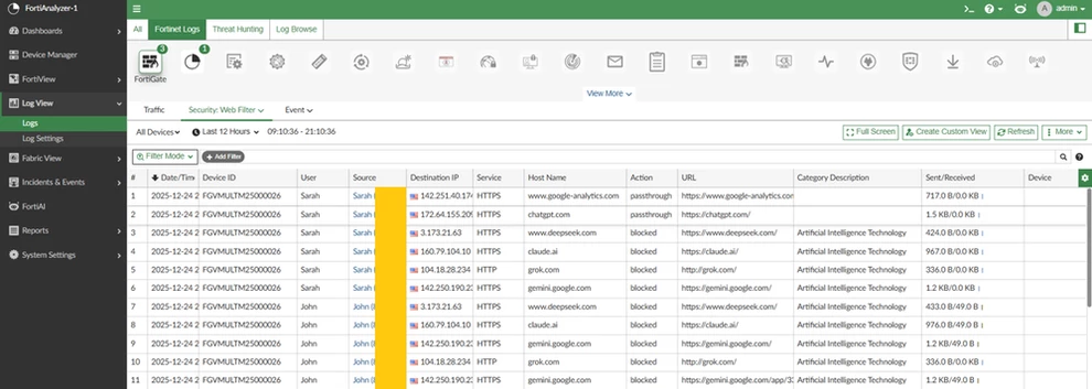

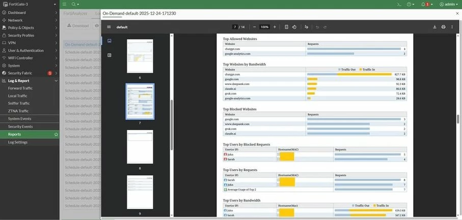

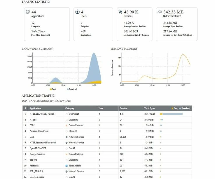

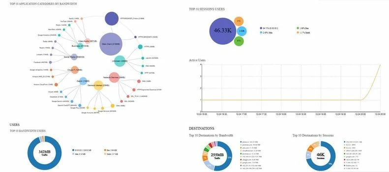

Use Case 9: Monitoring the AI/LLM application activity in the network - using FortiGate or FortiAnalyzer Logs & Reporting
FortiGate Logs & Reports, as well as FortiAnalyzer logs and detailed reporting, can be leveraged for extensive monitoring of the usage and activity of GenAI/LLM applications, similar to all the other applications in the network. Furthermore, using the analytics from these logs & reports, FortiGate policies can be further fine-tuned on an ongoing basis.
FortiGate Logs and Reports.

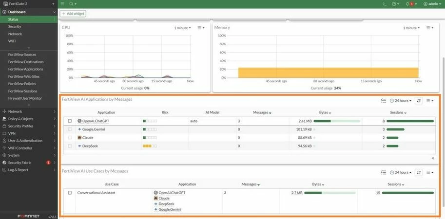

FortiGate with 7.6.4 & later versions have the new dashboard widgets specifically built to monitor AI applications and use cases, as shown in the example below. Select 'Add widget' in the top left corner of the Dashboard in the FortiGate GUI, and add the AI widgets to view the AI application usage summary in the network.

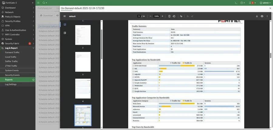

In the 'Reports' section of the FortiGate under 'Log & Report', a detailed application usage report can be created that shows the usage by application categories and bandwidth, including GenAI applications, as shown in the example below.
The report can also show GenAI application usage by top Users, including blocked requests.
FortiAnalyzer Logs and Reports

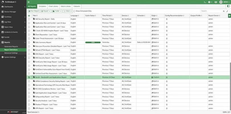

For more detailed and aggregated log analysis and Reporting, FortiAnalyzer can be used, which can provide granular and detailed reports of GenAI application traffic in the network. The 'Applications & Websites' section of the 'FortiView' pane in the FortiAnalyzer shows a separate category for 'Artificial Intelligence Technology', with various traffic usage statistics for users in the network, like threat scores, sessions, bytes, etc, as shown in the example below.

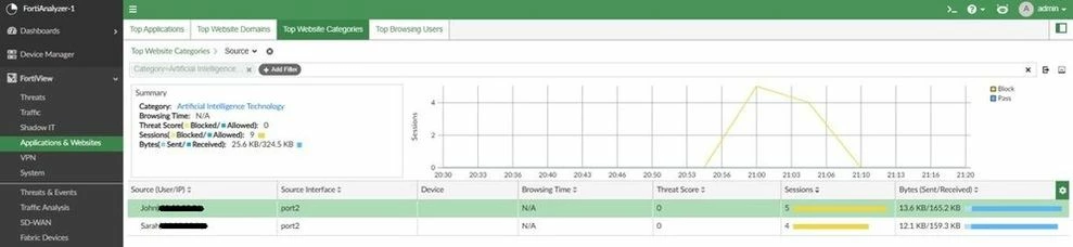

For a detailed analysis of the logs corresponding to the Artificial Intelligence Technology category traffic, use the 'Logs' section of the 'Log View' pane as shown in the example below, which highlights the GenAI application names/URLs along with the FortiGate policy actions applied to those sessions.

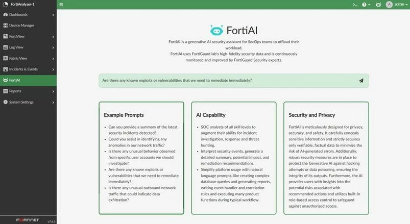

FortiAnalyzer also provides options to create detailed aggregated reports of GenAI application traffic in the network,  across multiple FortiGates. Reports can be customized as well to create very granular views of the intended data. Below is an example of one such report generated for application traffic and Bandwidth usage including GenAI applications. Steps to create custom reports with examples are here: Custom reports in FortiAnalyzer using Chart Builder and Custom reports in FortiAnalyzer for applications & category
In the FortiAnalyzer 7.6.0 & later versions, FortiAI security assistant is also available, which is a Generative Security AI assistant (powered by FortiGuard) that can be queried on various incident investigation, response, and threat hunting using iterative prompts. More details on the FortiAI assistant can be found here: FortiAnalyzer 7.6.0 New features - FortiAI.
