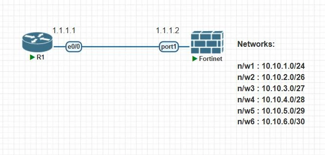

Here is a scenario:
FortiGate is connected to Networks: n/w1,: 10.10.1.0/24, n/w2 :10.10.2.0/26, n/w3 :10.10.3.0/27, n/w4 :10.10.4.0/28, n/w5 :10.10.5.0/29 and n/w6 :10.10.6.0/30.
All these connected routes get redistributed when redistribute 'connected' is enabled in BGP
config redistribute "connected"
    set status enable
If there is a need to block specific connected networks from getting advertised to the BGP neighbor, an access list needs to be created with a specific network ID; call it in Route-map and configure route-map-out in the BGP neighbor.
Example:
Out of all connected networks, n/w4: 10.10.4.0/28 and n/w5: 10.10.5.0/29 are not supposed to be advertised.
