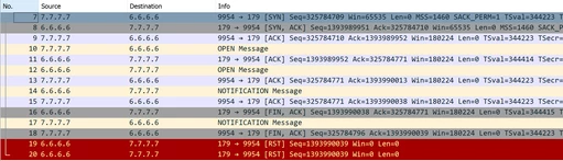

Debug will as below:
When F6 gets open message from F7 it will see the router id as 6.6.6.6 which is same as its Router ID and sends Notification Error Message:
'OPEN Message Error/Bad BGP Identifier'.
7 7.7.7.7 6.6.6.6 9954 → 179 [SYN] Seq=325784709 Win=65535 Len=0 MSS=1460 SACK_PERM=1 TSval=344223 TSecr=0 WS=16384
8 6.6.6.6 7.7.7.7 179 → 9954 [SYN, ACK] Seq=1393989951 Ack=325784710 Win=65535 Len=0 MSS=1460 SACK_PERM=1 TSval=344414 TSecr=344223 WS=16384
9 7.7.7.7 6.6.6.6 9954 → 179 [ACK] Seq=325784710 Ack=1393989952 Win=180224 Len=0 TSval=344223 TSecr=344414
10 7.7.7.7 6.6.6.6 OPEN Message
11 6.6.6.6 7.7.7.7 179 → 9954 [ACK] Seq=1393989952 Ack=325784771 Win=180224 Len=0 TSval=344414 TSecr=344223
12 6.6.6.6 7.7.7.7 OPEN Message
13 7.7.7.7 6.6.6.6 9954 → 179 [ACK] Seq=325784771 Ack=1393990013 Win=180224 Len=0 TSval=344223 TSecr=344415
14 6.6.6.6 7.7.7.7 NOTIFICATION Message
15 7.7.7.7 6.6.6.6 9954 → 179 [ACK] Seq=325784771 Ack=1393990038 Win=180224 Len=0 TSval=344223 TSecr=344415
16 6.6.6.6 7.7.7.7 179 → 9954 [FIN, ACK] Seq=1393990038 Ack=325784771 Win=180224 Len=0 TSval=344415 TSecr=344223
17 7.7.7.7 6.6.6.6 NOTIFICATION Message
18 7.7.7.7 6.6.6.6 9954 → 179 [FIN, ACK] Seq=325784796 Ack=1393990039 Win=180224 Len=0 TSval=344223 TSecr=344415
19 6.6.6.6 7.7.7.7 179 → 9954 [RST] Seq=1393990039 Win=0 Len=0
20 6.6.6.6 7.7.7.7 179 → 9954 [RST] Seq=1393990039 Win=0 Len=0
10th packet:
Packet comments
Frame 10: 127 bytes on wire (1016 bits), 127 bytes captured (1016 bits) on interface port1, id 0
Ethernet II, Src: 50:00:00:08:00:00 (50:00:00:08:00:00), Dst: 00:00:00_00:00:00 (00:00:00:00:00:00)
Internet Protocol Version 4, Src: 7.7.7.7, Dst: 6.6.6.6
Transmission Control Protocol, Src Port: 9954, Dst Port: 179, Seq: 325784710, Ack: 1393989952, Len: 61
Border Gateway Protocol - OPEN Message
Marker: ffffffffffffffffffffffffffffffff
Length: 61
Type: OPEN Message (1)
Version: 4
My AS: 64500
Hold Time: 180
BGP Identifier: 6.6.6.6
Optional Parameters Length: 32
Optional Parameters
12th packet:
Packet comments
Frame 12: 127 bytes on wire (1016 bits), 127 bytes captured (1016 bits) on interface port1, id 0
Ethernet II, Src: 50:00:00:07:00:01 (50:00:00:07:00:01), Dst: 00:00:00_00:00:01 (00:00:00:00:00:01)
Internet Protocol Version 4, Src: 6.6.6.6, Dst: 7.7.7.7
Transmission Control Protocol, Src Port: 179, Dst Port: 9954, Seq: 1393989952, Ack: 325784771, Len: 61
Length: 61
Version: 4
My AS: 64500
Hold Time: 180
Optional Parameters
14th packet:
Packet comments
Frame 14: 91 bytes on wire (728 bits), 91 bytes captured (728 bits) on interface port1, id 0
Transmission Control Protocol, Src Port: 179, Dst Port: 9954, Seq: 1393990013, Ack: 325784771, Len: 25
Border Gateway Protocol - NOTIFICATION Message
Length: 25
Type: NOTIFICATION Message (3)
Major error Code: OPEN Message Error (2)
Minor error Code (Open Message): Bad BGP Identifier (3)
Data: 06060606
17th packet:
Packet comments
Frame 17: 91 bytes on wire (728 bits), 91 bytes captured (728 bits) on interface port1, id 0
Transmission Control Protocol, Src Port: 9954, Dst Port: 179, Seq: 325784771, Ack: 1393990039, Len: 25
Length: 25
Data: 06060606
