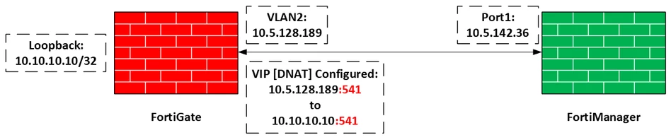

Scenario 1: A private Loopback IP address, which will require NAT to successfully establish connectivity to FortiManager.
Configuration:
    set type fortimanager
    set serial-number "FMGSN0123456789"
    set fmg "10.5.142.36"
    set fmg-source-ip 10.10.10.10
Solution:
FortiGate generates self-initiated traffic to connect to FortiManager, which is routed and sent out through a standard network interface. Source NAT cannot be applied to self-generated traffic, even if a firewall policy is configured, since firewall policies do not apply to self-generated traffic. Connectivity to FortiManager is expected to fail.

Scenario 2: A VIP/DNAT rule for port 541 pointing to the Loopback IP is configured on the interface through which FortiManager is reachable.
'fmg-source-ip" is set to 10.10.10.10 under "central-management' configuration.
config firewall vip
    edit "FMGVIP"
        set extip 10.5.128.189
        set mappedip "10.10.10.10"
        set extintf "VLAN2"
        set portforward enable
        set extport 541
        set mappedport 541
config firewall policy
        set name "FMGVIP"
        set srcintf "VLAN2"
        set dstintf "Loop"
        set srcaddr "all"
        set dstaddr "FMGVIP"
        set service "ALL"
        set logtraffic all
        set nat enable
Solution:
In this scenario, FortiGate will still attempt to source the traffic using IP 10.10.10.10, and the connection to FortiManager will fail because NAT must be performed on the egress interface.
If the discovery is initiated from FortiManager to FortiGate's VIP, the standard device discovery might fail with the message 'Probe Failed' as long as FortiGate cannot reach FortiManager from the IP address 10.10.10.10.
Using the 'Legacy Device Login' option allows a successful FortiGate import into FortiManager and enables configuration pushes from FortiManager to FortiGate. However, issues may occur if the session is cleared on the FortiGate or if the device is rebooted.
Removing the 'fmg-source-ip' setting and allowing the FortiGate to source traffic from a standard routed interface with reachability to the FortiManager enables successful tunnel establishment and mitigates unexpected behaviors.
