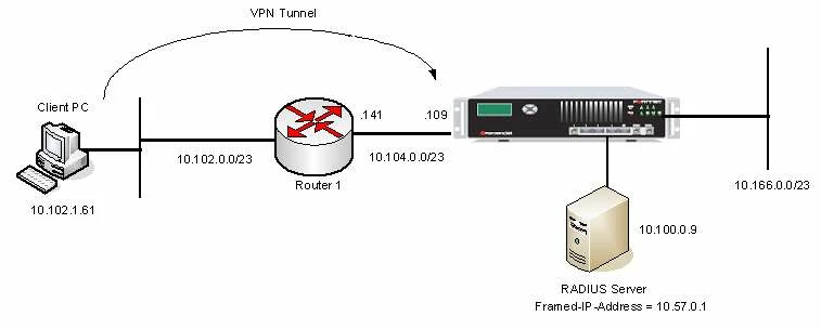

For Example:
Summary:
  • Client PC establishes a VPN tunnel to the FortiGate unit.
  • The FortiGate unit is setup to send authentication request forwarded to a RADIUS server.
  • If authentication is successful, RADIUS server sends Access Accept packets with the RADIUS attribute of Framed-IP-Address (the IP address assigned/reserved for the user.) back to the FortiGate unit.
  • The Client requests an IP address over DHCP-IPsec.
  • The FortiGate unit passes the address received from the RADIUS server to the client over DHCP-IPsec.
  • In this example port2 is the external port facing the client, and port5 is the interface facing the internal 10.166.0.0 subnet.
