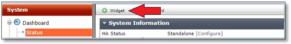

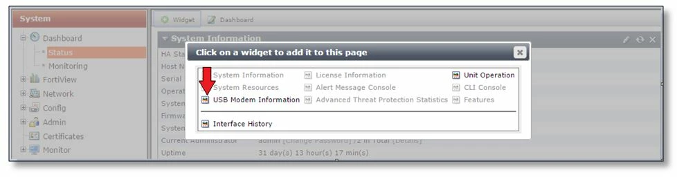

To begin you need to enable the USB Modem Information Widget.

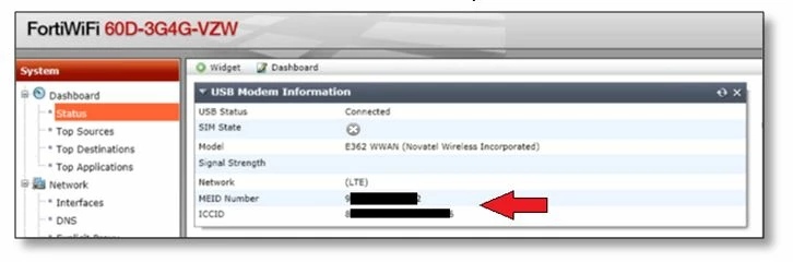

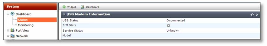

Initially the information on the widget will be grayed out.
When you plug in the SIM card, the MEID # from Verizon and the CCID# from the FortiGate will appear.
Call Verizon to make sure MEID # CCID# are paired.

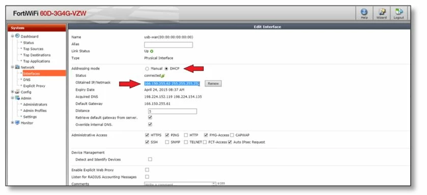

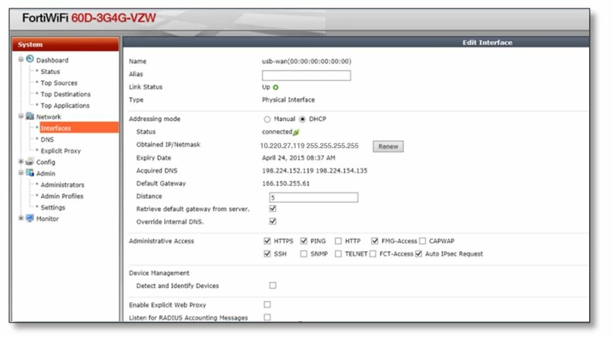

Initially the IP address that is assigned for this interface is a private IP address on the Verizon network. The original IP you get before receiving the static IP, is not accessible from the Internet
*Note, you will want the interface to be set for DHCP. Even though you have a static IP provided from Verizon, it is assigned by the Verizon network.
