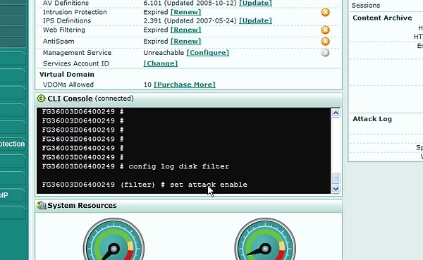

The steps below show how to enable and configure logging to Hard Drive.
Note :  FortiOS only allows the use of the CLI for this configuration.
This procedure is written for and can only be used with devices that have a Fortinet hard drive properly installed.
Configuration (CLI only)
Replace values between '<' and '>' with values from requirements.
config log disk filter
set app-ctrl enable
set attack enable
set dlp enable
set email enable
set event enable
set severity information
set virus enable
set web enable
set anomaly enable
set app-ctrl-all enable
set blocked enable
set dlp-all enable
set email-log-imap enable
set email-log-pop3 enable
set email-log-smtp enable
set ftgd-wf-block enable
set ftgd-wf-errors enable
set infected enable
set oversized enable
set signature enable
set url-filter enable
set web-content enable
set web-filter-activex enable
set web-filter-applet enable
set web-filter-cookie enable
config log disk setting
set status enable
Important : Once these steps have been performed in CLI the user must log out and log in as a GUI option has been added.
Console in GUI can be used to simplify this procedure in not requiring a terminal connection
Verification
In order to generate log events for the settings now made a CLI command can be used : Console in the GUI can be used in order to perform this in simple steps.
CLI log test command:
#diagnose log test
