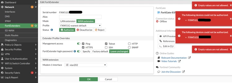

The FortiGate GUI may present the following errors when the User tries to authorize the FortiExtender:
'The following devices could not be authorized.'
'Empty values are not allowed.'
  1. This is a known issue on FortiOS, and the fix is now available in the new FortiOS v7.4.8 GA.
See 1114549: Authorization of FEXT devices fails when using the FortiGate GUI - FortiGate resolved issues.
  1. Alternatively, if the FortiGate firmware upgrade is not possible, as a temporary workaround, the User can authorize the FortiExtender via FortiGate CLI commands as shown below:
config extension-controller extender
    edit "FXW51GSXXXXXXXXX"
        set id "FXW51GSXXXXXXXXX"
        set authorized enable              <----- Ensure the authorized command is enabled.
        set device-id 0
        set extension-type wan-extension
        set profile "FXW51G-wanext-default"
            config wan-extension
                set modem1-extension "<interface_name>"        <----- Ensure modem1-extension interface name is mapped.
Note: The same command can be used to authorize FortiExtender in the 'lan-extension' or 'wan-extension' modes.
