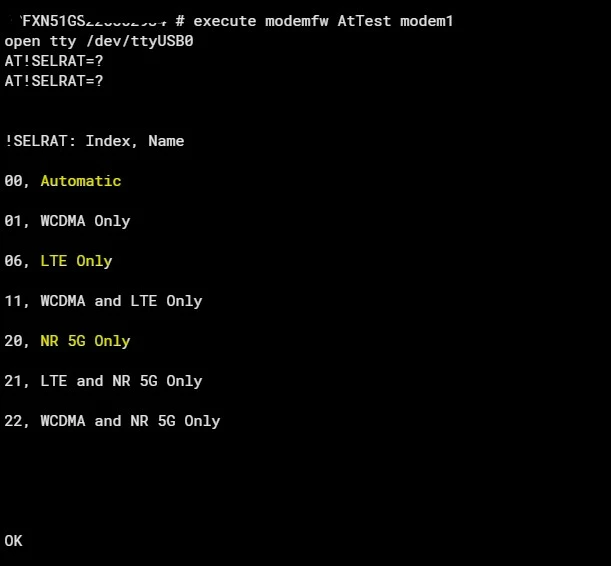

By default, the AT!SELRAT setting is Automatic, and the modem allows the following values:
execute modemfw AtTest modem1
open tty /dev/ttyUSB0
AT!SELRAT=?
!SELRAT: Index, Name
00, Automatic
01, WCDMA Only
06, LTE Only
11, WCDMA and LTE Only
20, NR 5G Only
21, LTE and NR 5G Only
22, WCDMA and NR 5G Only
ATSELRATATSELRAT

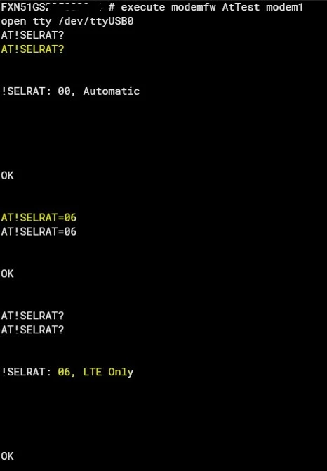

If the FortiExtender is not able to establish a 4G LTE or a 5G connection using the 'Automatic' setting, try forcing the modem to establish LTE only or a 5G only connection, and verify whether the data connection works using either connection mode (LTE only or 5G only):
  1. If the SIM Carrier has a poor 5G coverage in the area where the FortiExtender is deployed, force LTE only connection and verify if the modem establishes a 4G LTE connection, using the 'get modem status' command:
AT!SELRAT?
AT!SELRAT=06
  • Use 'AT!SELRAT?' command to view the current RAT config.
  • Press 'Ctrl+C' to exit the AT command prompt and see the 'get modem status' output for connection status.
  • Reboot the FortiExtender (execute reboot) and wait for up to 5 minutes to see if the modem connection status changes.
LTE onlyLTE only
