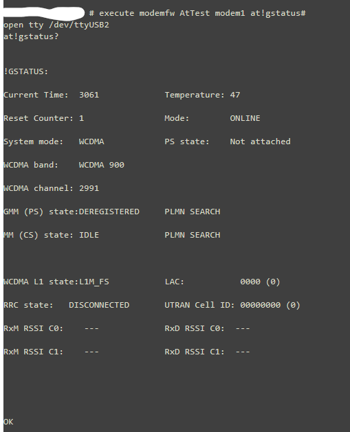

This can be confirmed by running the following:
get modem status
execute modemfw AtTest modem1 at!gstatus#

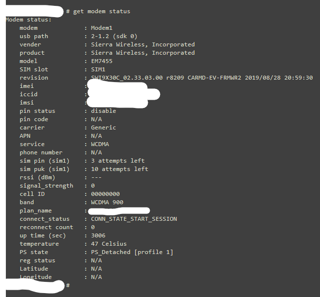

The outputs below demonstrate that the modem is being detected, but it is not attached to a packet service and not registered on the network.
If the SIM is present, has been provisioned correctly, and is active: proceed with the following steps.

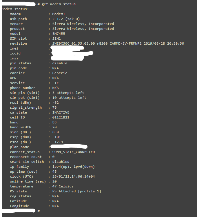

Step 10: After the modem has been rebooted, issue the 'get modem status' command to confirm whether the modem is now attached to LTE-only mode and whether the FortiExtender modem is connected to the Packet Service, and if it is registered on the network.
Now, as depicted in the output. the modem is attached to LTE-only mode and the modem is connected to the Packet Service and it is registered on the network.
