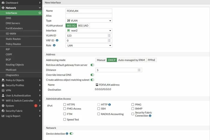

3) Create a VLAN interface on top of WAN2 (any VLAN ID i.e. 123). Name it FEXVLAN. Make this interface type DHCP client.

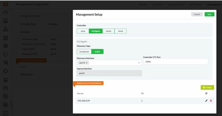

5) On FortiExtender GUI -- > Navigate to Setting -- > Management, set Controller: FortiGate, Discovery Type: static, Discovery Interface: port4, and create Static Access Control Address with the server: 192.168.2.99.

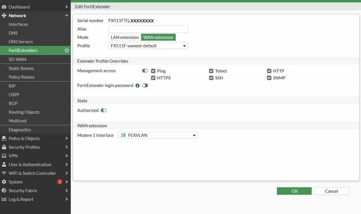

6) To Authorize FortiExtender on FortiGate GUI -- > Navigate to Network -- > FortiExtender, and wait for the FortiExtender to be discovered by FortiGate and then Authorize FortiExtender with mode: WAN extension, Modem 1 Interface: FEXVLAN.
7) Wait a few moments, FortiExtender may need to reboot if the mode was changed from nat to ip-passthrough (VLAN).

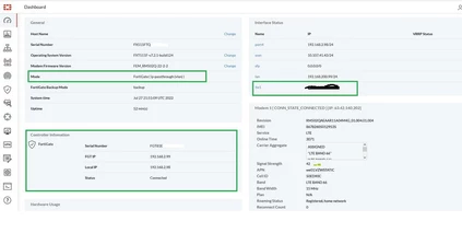

8 ) After the WAN extension tunnel was set up, check the status from FortiExtender GUI -- > Dashboard, Controller Infomation should be: FortiGate, with Status: Connected, and Mode is: FortiGate (ip-passthrough (VLAN)).

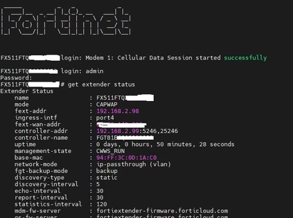

9) WAN Extension status can be found from FortiExtender CLI also, by running the below command:
# get extender status

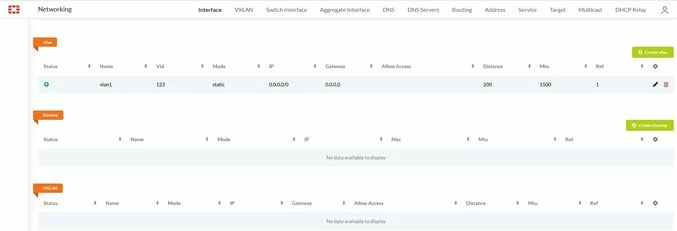

10) The FortiGate will send the VLAN ID to FortiExtender over CAPWAP and FortiExtender will creates a VLAN interface automatically with name VLAN1, vid 123, for example, no special config needed.

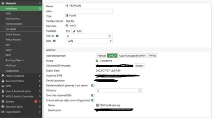

11) Now when the FortiExtender modem is connected to the Internet, the FortiGate VLAN interface FEXVLAN will get the same IP address as the FortiExtender LTE interface.
