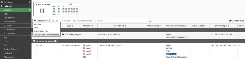

  1. On FortiGate, create a wan2 interface & configure an IP address 192.168.2.99 with a DHCP server running on it and allow Security Fabric connection traffic.

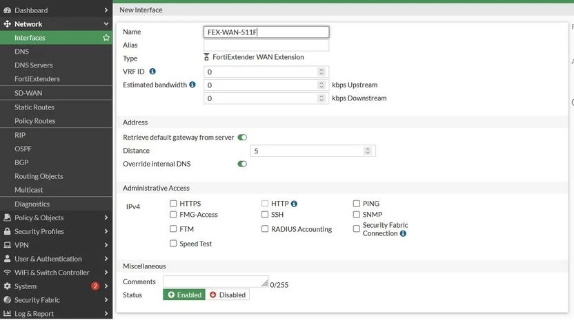

  2. Create a FortiExtender WAN Extension interface. Let's call it FEX-WAN-511F.

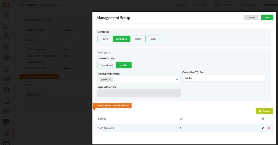

  2. On FortiExtender GUI - Navigate to Setting -> Management, set Controller: FortiGate, Discovery Type: static, Discovery Interface: port4, and create Static Access Control Address with the server: 192.168.2.99.

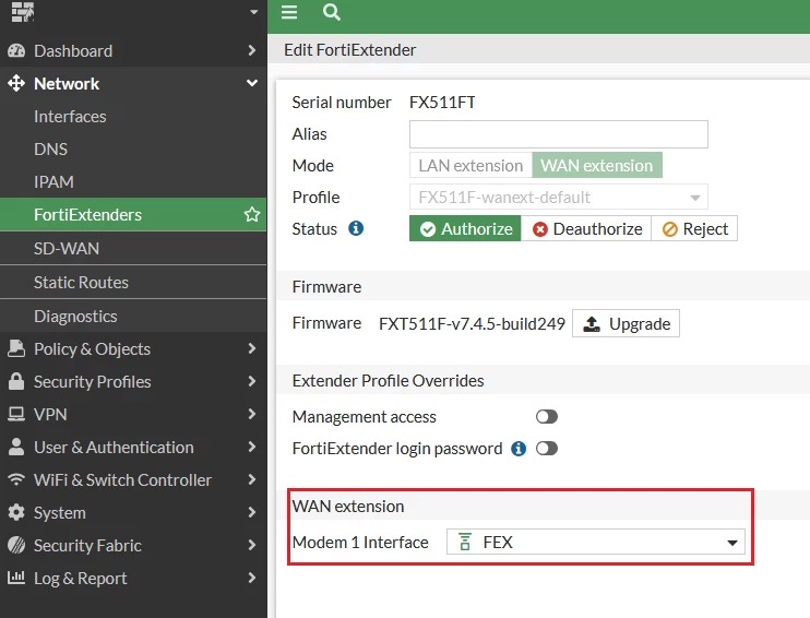

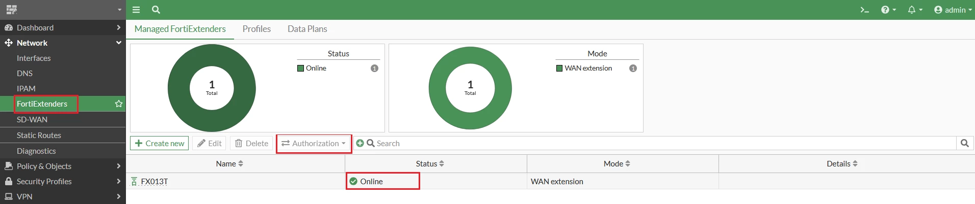

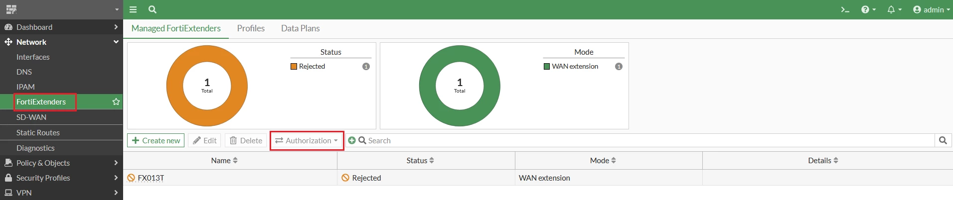

  1. To Authorize FortiExtender on FortiGate GUI - Navigate to Network -> FortiExtenders, and wait for the FortiExtender to be discovered by FortiGate and then select it and under the Authorization drop-down select  Authorize. Wait for the status to become online. Make sure the Modem 1 Interface is selected under the WAN Extension with the extender interface that was created previously, see the last screenshot below.
  1. Wait for some minutes, FortiExtender may need to reboot if the mode was changed from nat to ip-passthrough.

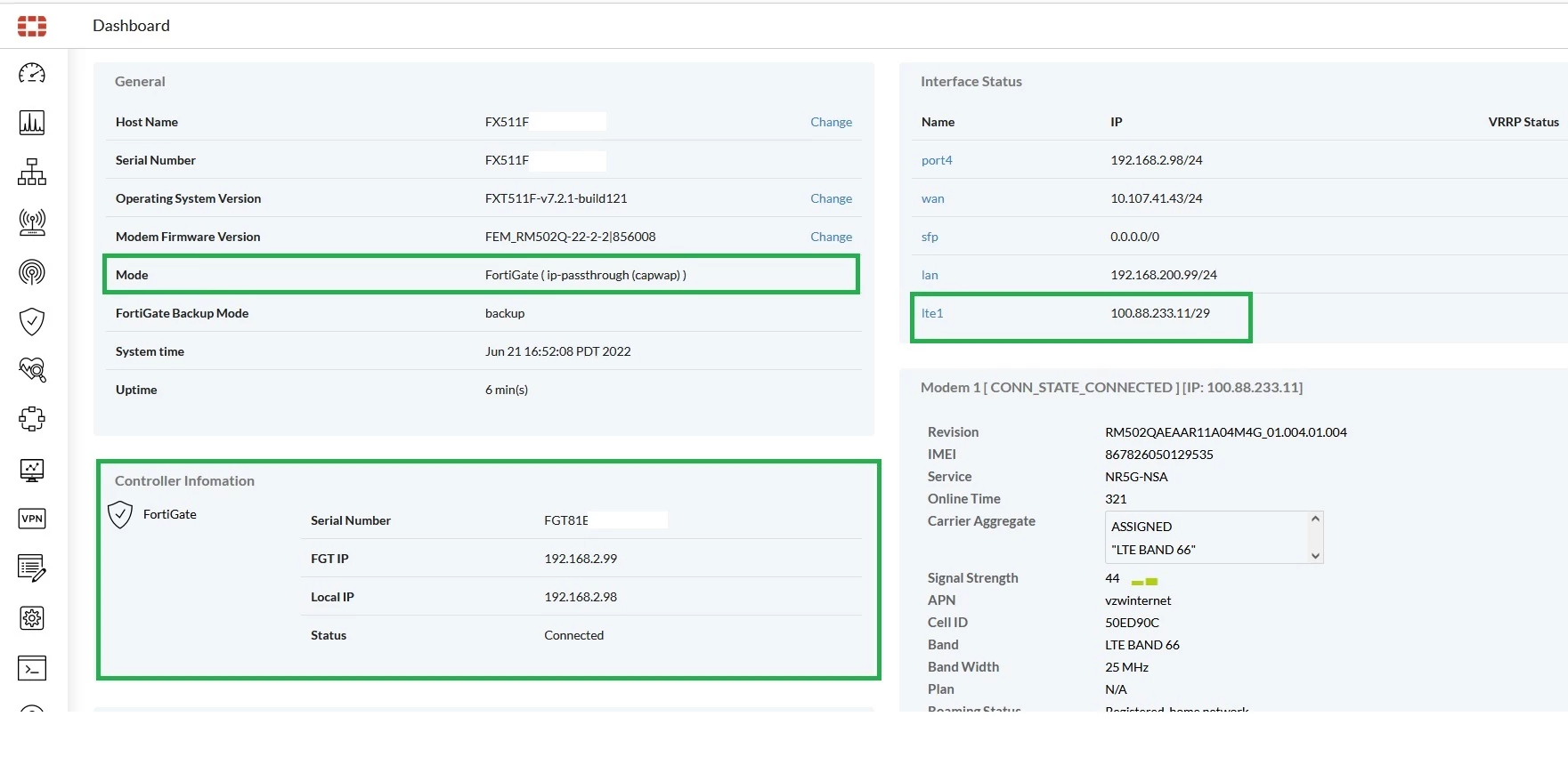

  2. After the WAN extension tunnel is set up, the services like HTTPS, SSH, and Ping need to be enabled, then login GUI to check the status from FortiExtender GUI - Dashboard, Controller Infomation should be: FortiGate, with Status: Connected, and Mode is: FortiGate (ip-passthrough (capwap)).

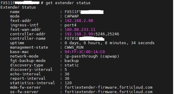

  1. WAN Extension status can be found from FortiExtender CLI also, by running the below command:
get extender status

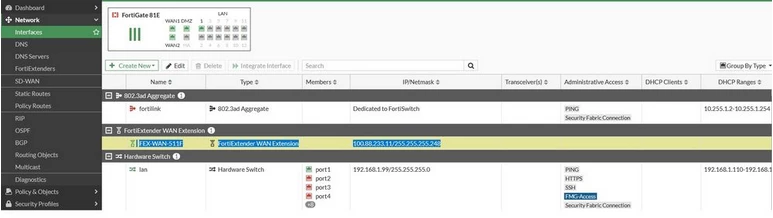

  1. When the FortiExtender modem is connected to the Internet, the FortiGate interface FEX-WAN-511F will get the same IP address as the FortiExtender LTE interface.
  1. On FortiGate, after configuring the correct firewall policy, the client behind FortiGate can go to the internet via the FEX-WAN-511F interface.
