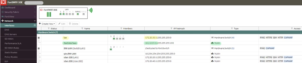

Screenshot 1: FortiGate with two interfaces for FortiExtender– LAN (Hardware Switch) & VLAN interface as shown below:

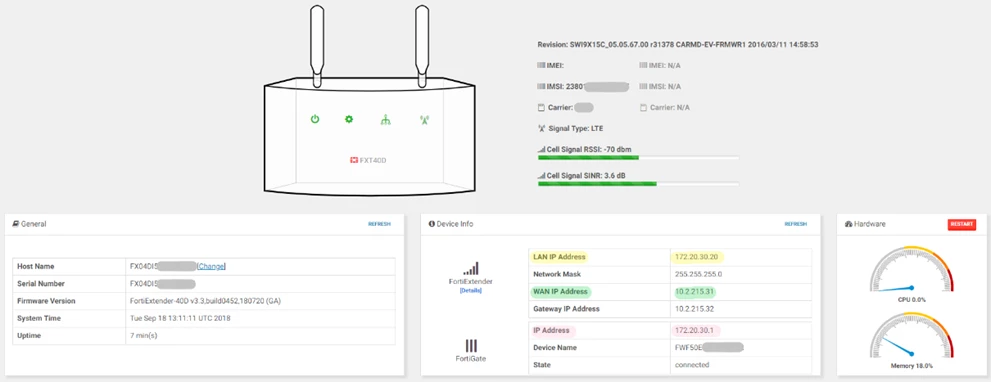

Screenshot2: FortiExtender GUI showing FortiExtender management and WAN IP address as shown below:

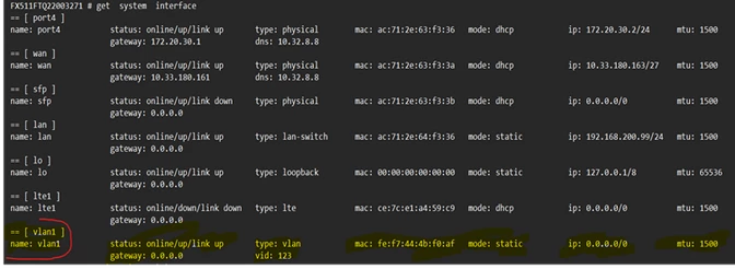

Screenshot 3:  Forti Extender CLI showing automatically created VLAN interface with VLAN ID 123. i.e.  'nas1.123'  or 'vid:123'

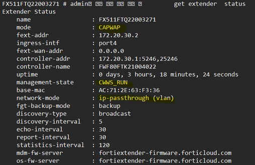

Screenshot 4: FortiExtender CLI showing extender status in vlan mode:
