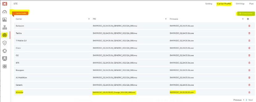

Screenshot 1: ‘Mobistar’ Carrier profile as shown below:
Screenshot 2: ‘Mobistar’ MCC MNC map as shown below:
Screenshot 3: ‘Mobistar’ APN settings as shown below:

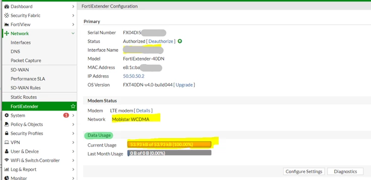

Screenshot 1: FortiExtender managed by FortiGate GUI - ‘Mobistar’ Data Connection usage status as shown below:

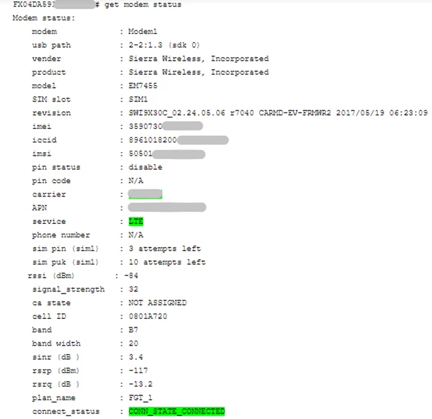

Screenshot 2: FortiExtender 'get modem status' command output shows ‘connect status’ is connected as shown below:

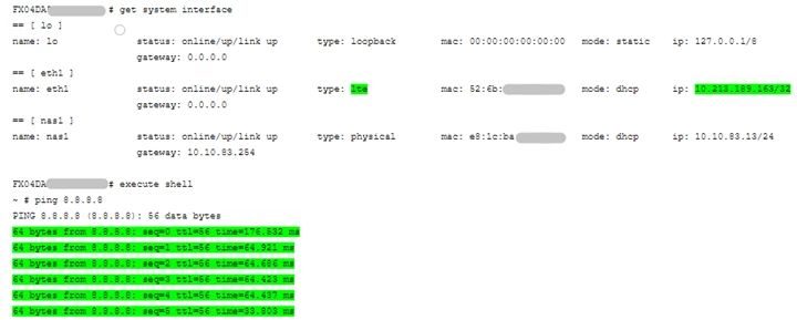

Screenshot 3: FortiExtender 'get system interface' command output shows FortiExtender has received Public IP address from ISP and also FEX can ping internet address as shown below:

- To validate if the SIM card is detected by modem, 'get modem status' output shows SIM slot, IMEI, ICCID, IMSI values as show below. If not, then follow the next steps:
# get modem status
Modem status:
    modem             : Modem1
    usb path          : Modem index1
    vender            : Sierra Wireless, Incorporated
    product           : Sierra Wireless, Incorporated
    model             : EM7305
    SIM slot          : SIM1
    revision          : SWI9X15C_05.05.58.00 r27038 carmd-fwbuild1 2015/03/04   21:30:23
    imei              : 3577260XXXXX
    iccid             : 89320XXXXXX
    imsi              : 20610XXXXXX
