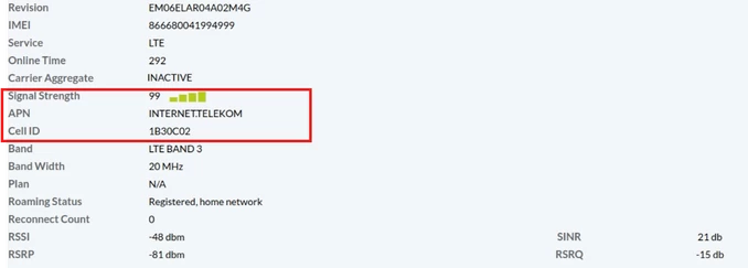

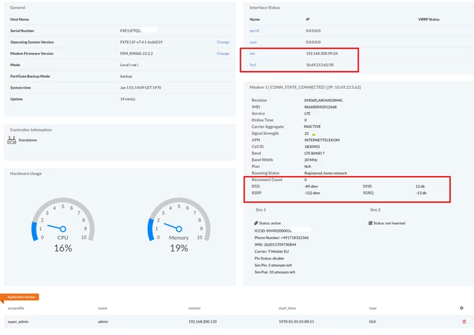

Go to FortiExtender GUI -> Dashboard and check for modem paramters RSRP, RSRQ, SINR, and RSSI.
RSRP, RSRQ, SINR, and RSSI are values that measure the quality and strength of a cellular signal. These values can be used to adjust the antenna of a router, modem, or repeater to get a stable and fast connection.
Refer to Display-rssi-signal-information to understand the recommended values for RSRP, RSRQ, SINR, and RSSI for optimum signal strength and quality LTE/5G internet speed.
