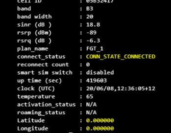

- FortiExtender 'get modem status' output - LTE connect status has to be 'Connected' as shown below:
1) When FortiExtender is connected to Internet via LTE connection – FEX shows latitude and longitude values as 0.000000 in 'get modem status' output as shown below:

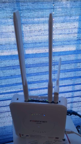

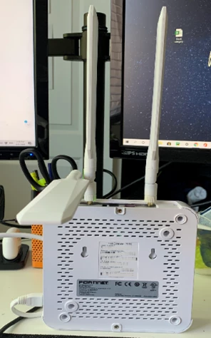

3) FortiExtender antennas have to be positioned as depicted in the following sample pictures:

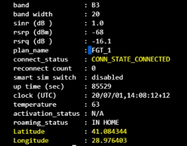

4) Once antennas are plugged on FortiExtender - reboot FortiExtender and wait for about 5-10 minutes and then check if 'get modem status' output shows non-zero latitude and longitude values and also if modem connection status shows as 'Connected' as shown below:
