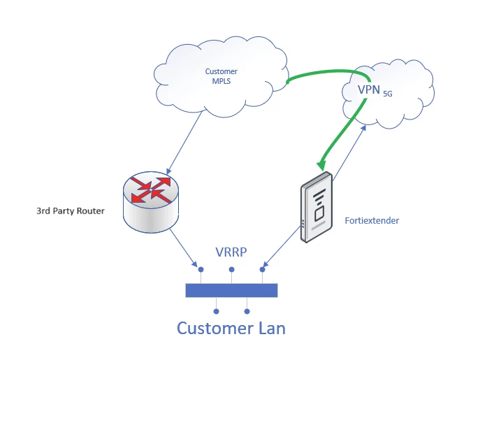

Consider the below topology :

  2. FortiExtender has to be in IP -passthrough mode for VRRP to happen.
config system management
(management)# set discovery-type local
(management) <M># config local
(local)# set mode ip-passthrough
#end
