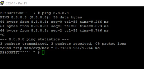

  1. Connect the console/SSH to the FortiAP and check if the FortiAP can reach the internet:

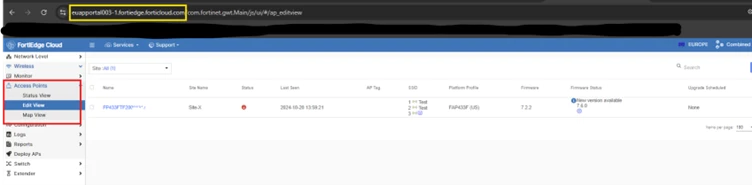

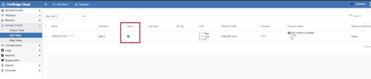

  2. Go to FortiEdge Cloud -> Nextwork -> Access Points -> Edit View. Copy the URL of the FortiEDGE cloud where FortiAP shows offline.

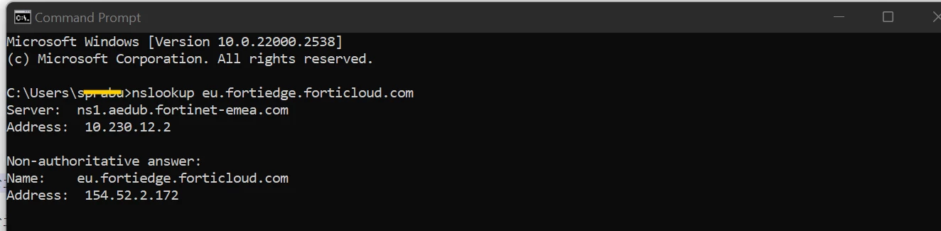

  3. Perform Nslookup for the cloud URL 'nslookup eu.fortiedge.forticloud.com' in a laptop to find the public IP.

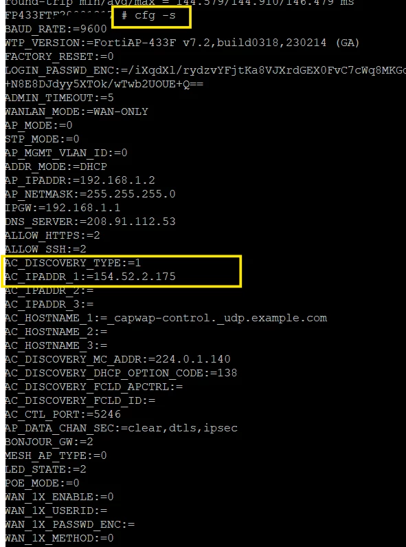

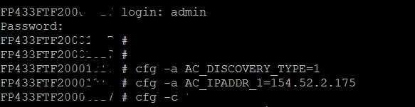

  4. Configure the resolved IP on the FortiAP and discovery type 1.

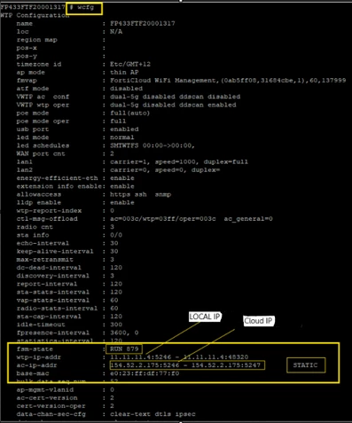

  5. The configuration will show up in #cfg -s.
  6. Run #wcfg on the FortiAP console/CLI to check the FortiAP FSM state :
  7. FortiAP status on FortiEdge Cloud:
