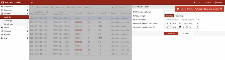

Troubleshooting Tip: 'Failed to download PDF report due to an exception'
  • December 11, 2024
  • 262 views
Description This article describes how to fix the issue of 'Failed to download PDF report due to an exception'.
FortiDeceptor v6.0.0 and v6.0.1.
The Error Message 'Failed to download PDF report due to an exception' appears when trying to select Incident -> Analysis -> PDF Report.
The issue can be resolved by upgrading the firmware to v6.0.2 build 0058 or above.
