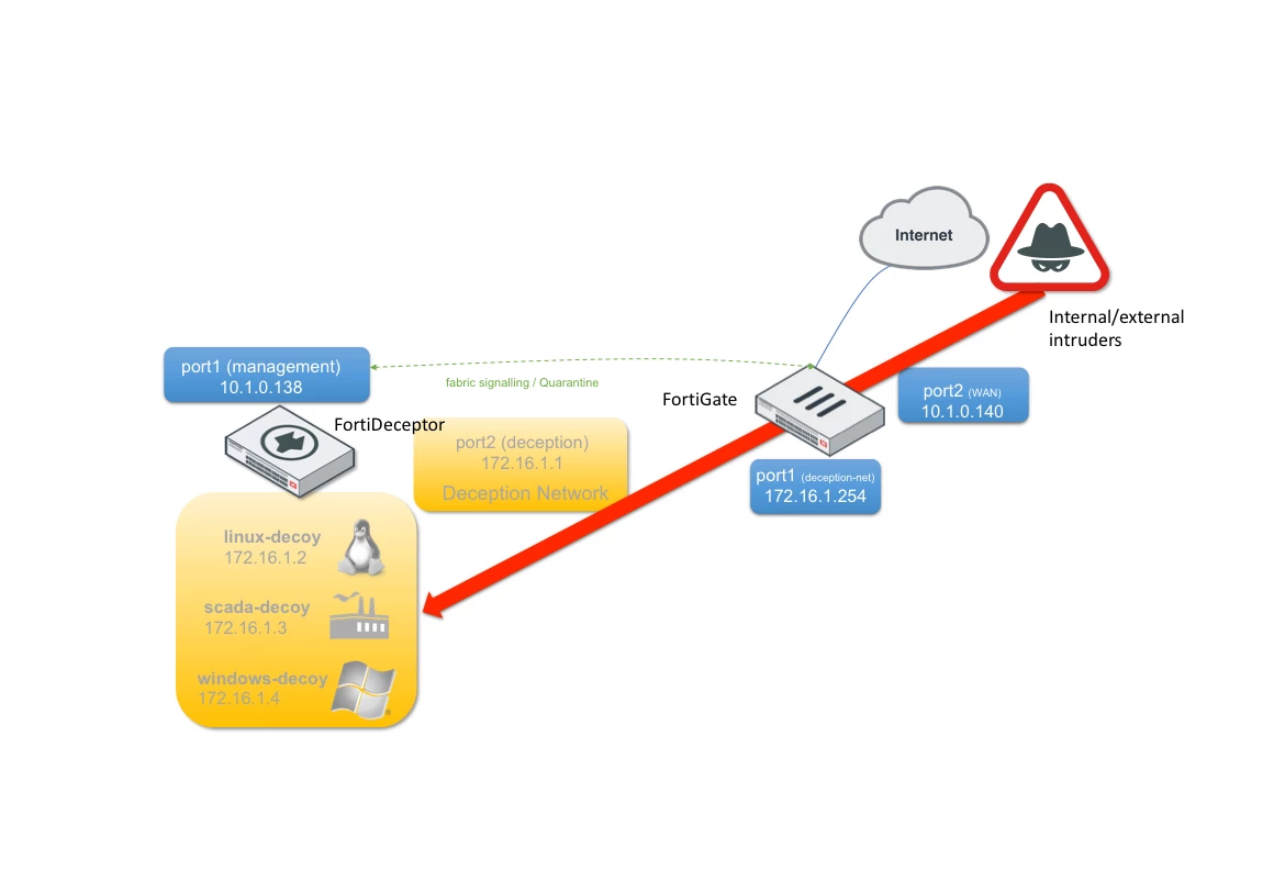

In the diagram below FortiDeceptor is using port1 to access internet (via a FortiGate).
Port2 of FortiDeceptor is used as deployment network for decoys to access internet.
