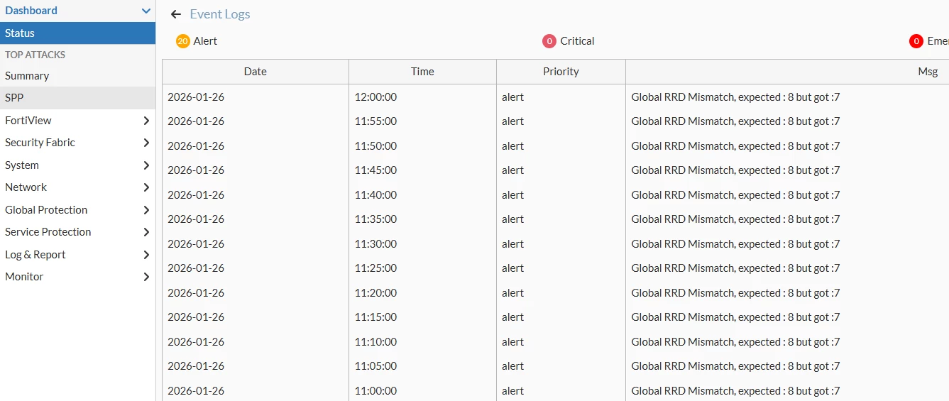

  1. The FortiDDoS-F may show the error logs 'Global RRD Mismatch' after firmware upgrade to v7.2.x.
  1. Run the debug commands in the FortiDDos-F CLI shell realm to check on the RRD files.
Fortiddos-F # diagnose debug rrd_files_check
