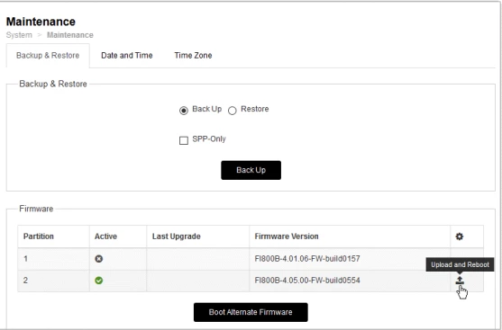

Updating firmware using GUI.
The following figure shows the user interface for managing firmware. Firmware can be loaded on two disk partitions. You can use the web UI to boot the firmware version stored on the alternate partition or to upload and boot firmware updates (either upgrades or downgrades).

To install firmware:
  1. Go to System -> Maintenance -> Backup & Restore tab.
  2. Under Firmware Upgrade/Downgrade, use the controls to select the firmware file desired to install and select the Update and Reboot icon.
      Note: Clear the cache of the web browser and restart it to ensure that it reloads the web UI.
  3. Use the upload file to select the firmware image file.
  4. Select OK to upload the file, and install the firmware.
