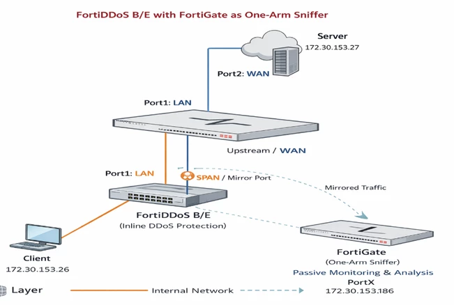

Description This article describes how use FortiGate as a 'one-armed sniffer' for dropped packet capture.
Scope FortiDDOS B/E.
FortiGate One-Arm Sniffer mode provides passive, out-of-band traffic capture, including dropped packets, and enables advanced troubleshooting and security analysis without impacting production traffic.

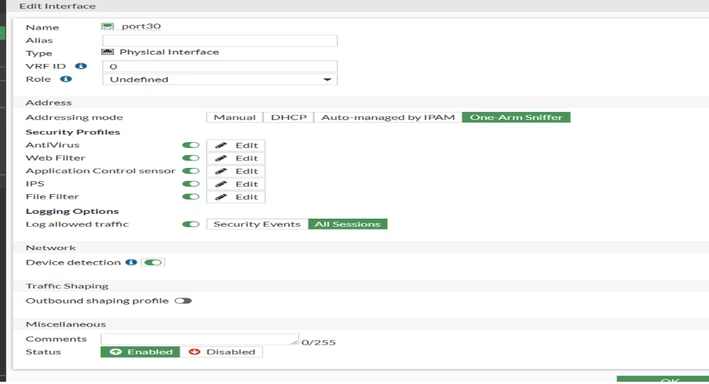

FortiGate:
Network -> Interface.

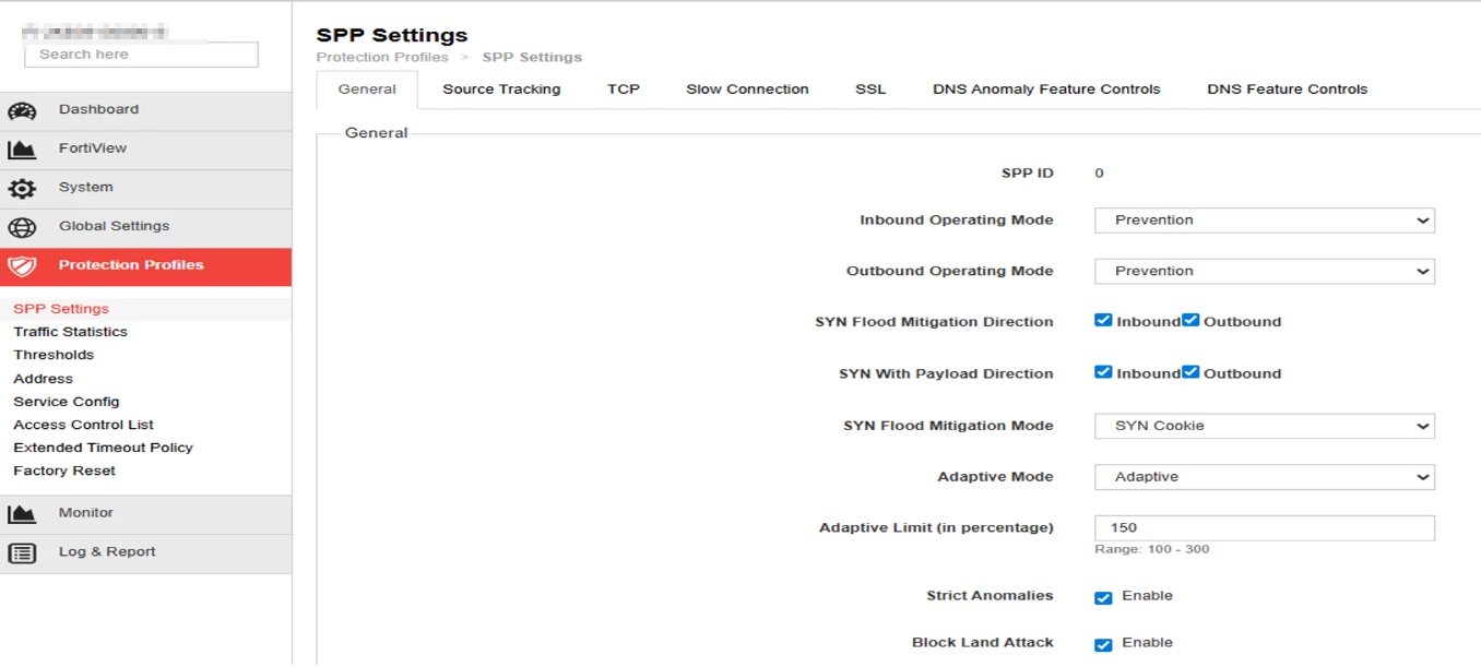

FortiDDoS:
  1. SPP-Default (prevention).
  1. Enable Dropped Packet Capture on the interface.

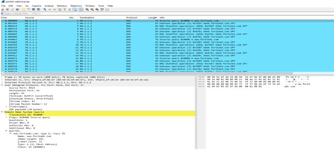

'One-armed sniffer' check:
