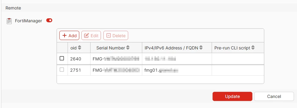

  3. Configure the target FortiManager with Serial Number and IP/FQDN under FortiZTP -> Settings -> FortiGate (optional pre-run CLI templates):

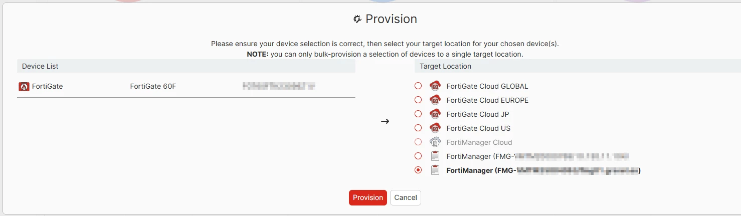

  1. Provision the FortiGate to the required FortiManager:
  1. After provisioning, FortiDeploy will wait for FortiGate to connect and the status will be 'Incomplete-Waiting':
  1. FortiGate must be in a factory-reset status without any changes applied, including the password, and the Internet connectivity must be guaranteed by DHCP. The FortiGate will attempt connection to FortiDeploy. Once connected, the configuration will be pushed and the FortiGate will register in FortiManager. This happens every 2 minutes.
  2. After a while, FortiZTP will update the status of the device to 'Provisioned':
