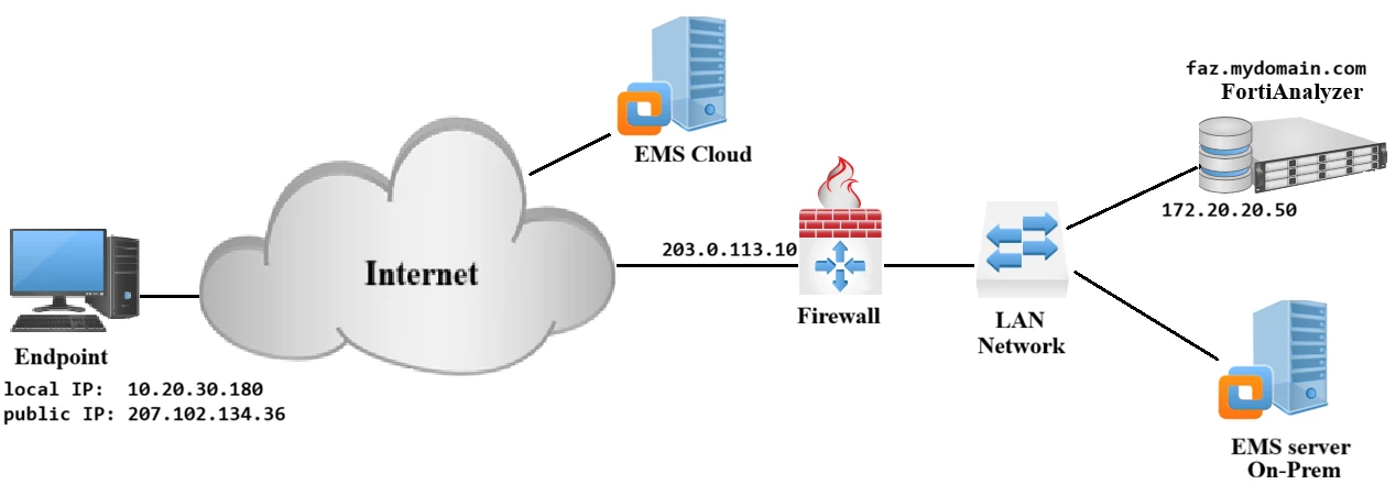

The following topology will be used to validate the configuration and conduct network connectivity testing and debugging on FortiAnalyzer.

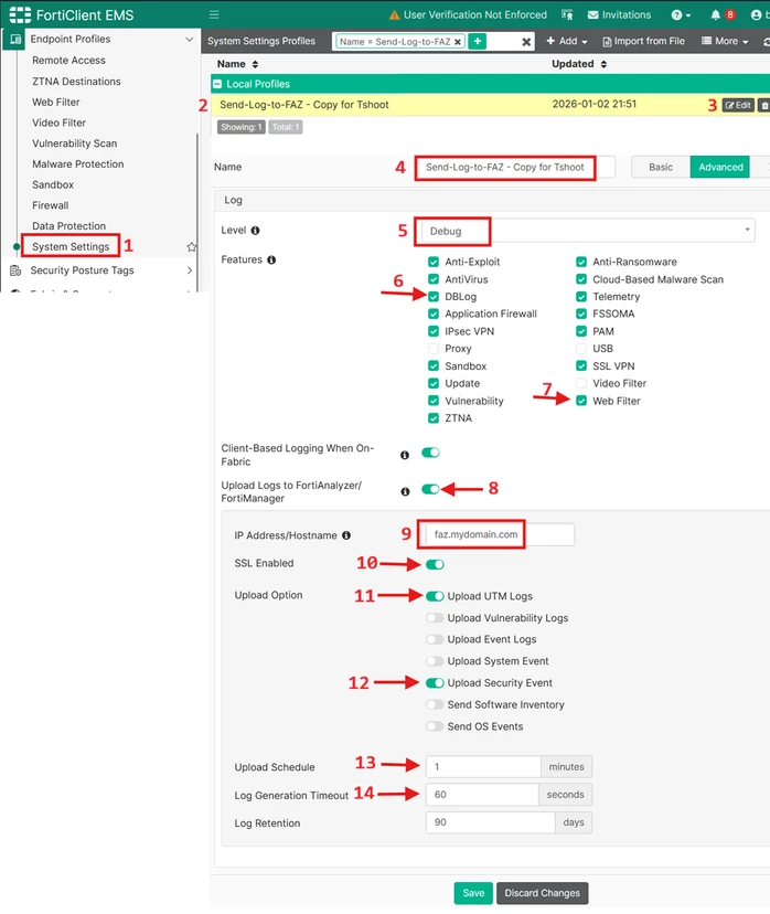

  1. Ensure FortiClient has the correct configuration:
    1. Verify which policy being used by the endpoint and what the Status is (on-fabric or off-fabric)
    2. Locate the policy and find out which System Settings profile is assigned to the PC
    3. Edit the corresponding profile ensure the correct FortiAnalyzer IP/FQDN is assigned for the option 'Upload Logs to FortiAnalyzer/FortiManager'.

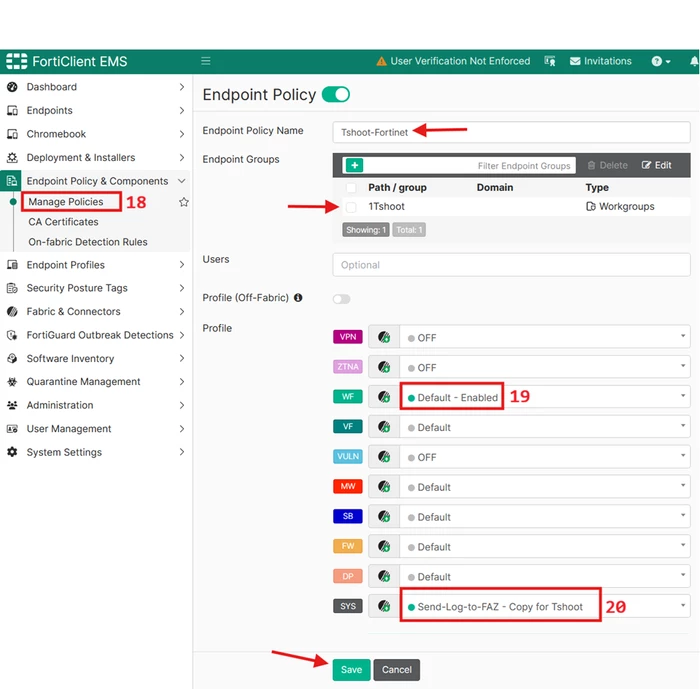

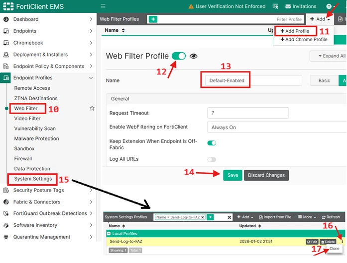

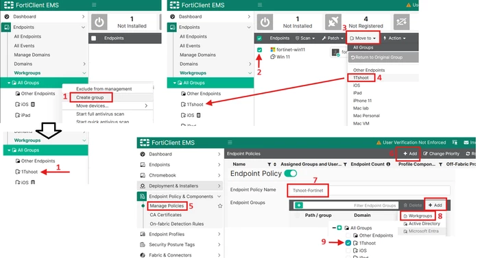

    4. For the troubleshooting purpose, isolate a test PC by creating a new test group under Workgroup or Domain in EMS -> Move the test PC under this new group -> Create a new policy and assign the newly created group -> Create a default enabled web filter profile -> Clone the current in-production System Settings profile -> Assign both profiles to the new policy -> Make the following changes under the cloned (test) System Settings profile:
      1. Set the Log Level to Debug and enable the 'DBLog' checkbox.
      2. Enable only the options SSL Enabled, Upload UTM Logs and Upload Security Event, and turn off the rest.
      3. Set Upload Schedule to one minute and Log Generation Timeout to 60 seconds to trigger faster log generation on the client side.

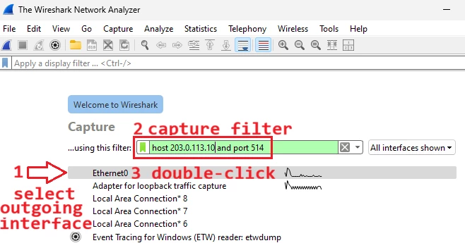

    1. Wireshark capture: Open Wireshark -> select the outgoing interface to the internet (e.g W-Fi) -> type host [FortiAnalyzer public IP] and port 514 -> double-click on the interface -> generate some logs by browsing a few unallowed websites such as guns.com, gambling.com, 777.com, wine-searcher.com, modelmayhem.com, match.com, or hitimes.com -> ensure the outgoing traffic has been seen in Wireshark -> wait for a minute -> Ensure that TCP packets over port 514 can be observed being exchanged between the client and the FortiAnalyzer.

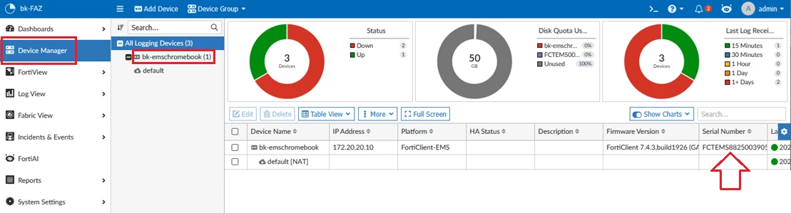

    1. Ensure the EMS serial number is added under FortiAnalyzer -> Device Manager. The EMS SN can be added manually, and there is no need to establish a Fabric Connector between EMS and FortiAnalyzer. The red circle indicator is expected behavior when the EMS server itself is not sending any logs to FortiAnalyzer.

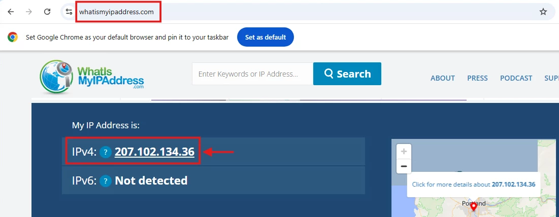

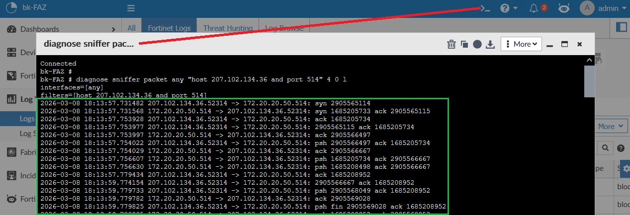

    1. To verify the connectivity, if the firewall is not using NAT between the internet and FortiAnalyzer, run the below command to verify if the traffic from the endpoint with public IP 207.102.134.36 reaches FortiAnalyzer over port 514:
diagnose sniffer packet any "host 207.102.134.36 and port 514" 4 0 l

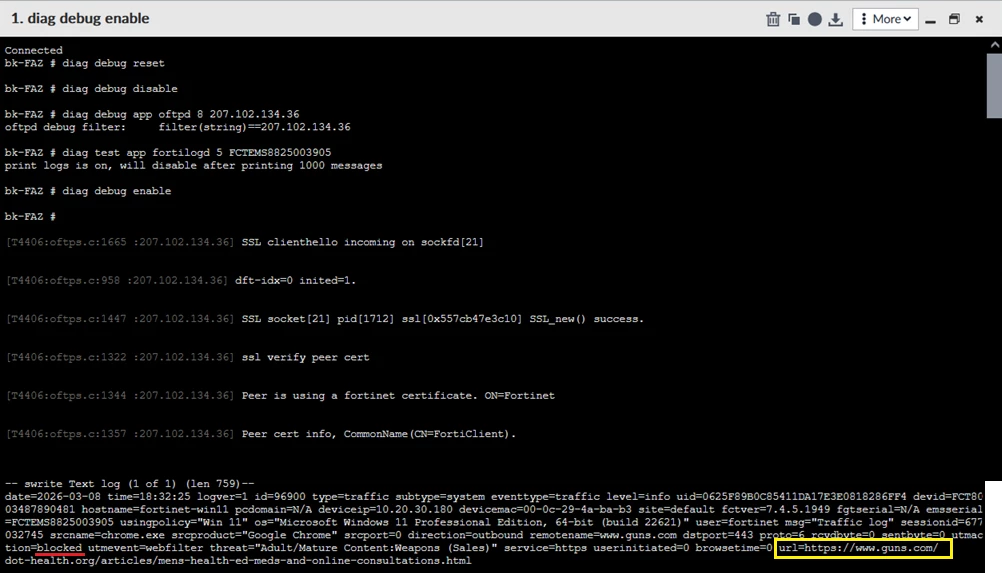

    1. To observe web filter logs, first run the commands below in the FortiAnalyzer console:
diagnose debug reset diagnose debug disable diagnose debug application oftpd 8 207.102.134.36 diagnose test application fortilogd 5 FCTEMS8825003905 diagnose debug enable
207.102.134.36 is the PC's public IP.
FCTEMS8825003905 is the FortiClient EMS serial number.

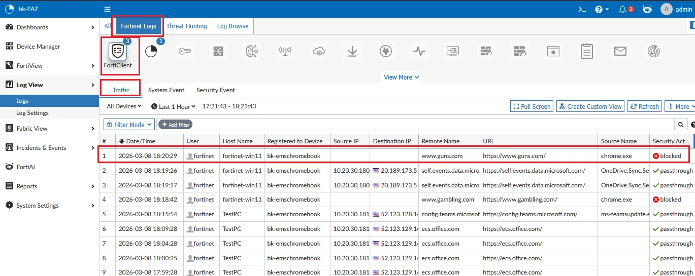

Then, generate some logs by browsing a few unallowed websites such as guns.com or gambling.com:
Wait for a few moments. The blocked URLs should show up in the FortiAnalyzer console output:
Navigate to FortiAnalyzer -> Log View -> Logs -> Select FortiClient -> Select Traffic or Security Events -> observe web filter events that happened on the endpoint:
