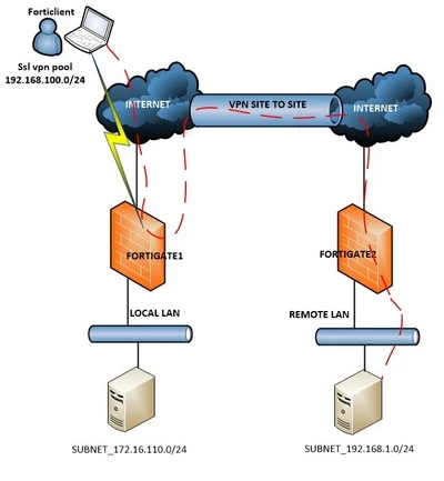

Technical Tip: How to route traffic from FortiClient through a VPN Site to Site
This article describes how to configure routing and permissions on FortiGate to allow the communication from the SSL VPN FortiClient to reach a Remote LAN through a VPN Site to Site.
FortiGate and FortiClient.
After the SSL VPN connection has been established, it is necessary to create a phase2 on the VPN site to site to allow the communication from the pool of the SSL VPN configured for the FortiClient to the remote LAN on the second FortiGate.
This configuration has to be established on both FortiGates of the VPN site to site connection.

Test of communication
From the PC connected to the FortiClient with the IP 192.168.100.1 (pool of the SSL VPN) to the remote IP 192.168.1.99.
FortiGate1

The communication from the PC is routed from the ssl.root interface on the FortiGate1 to the VPN interface (VPNForti) after that the packets reach the second FortiGate by the VPN (VPN_FORTI) and finally the communication is completed.
