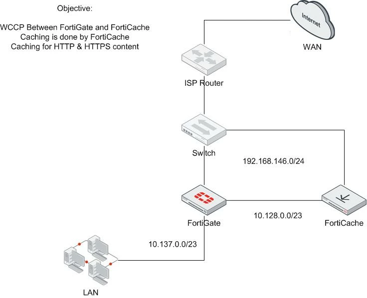

This article describes the necessary steps to setup and configure FortiCache and FortiGate with web-caching enable using WCCP.
Web-caching for HTTP and HTTPS contents over WCCP between FortiGate and FortiCache.
Diagram

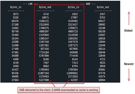

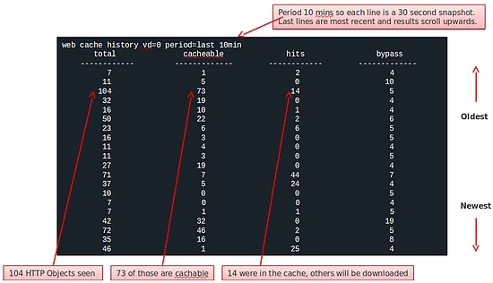

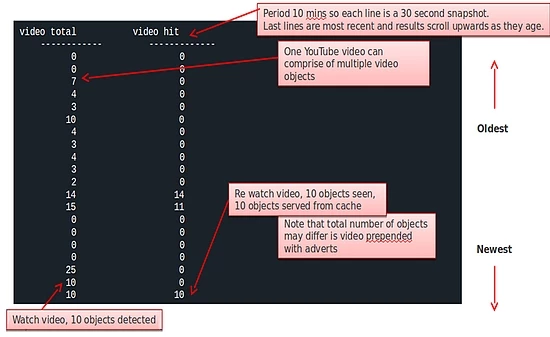

# diag wad web list 10min
Troubleshooting
Troubleshooting commands
get sys perf stat
diag test app wad 1
diag test app wad 50
