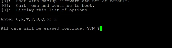

  1. Press [F] to begin formatting the boot device. This process will erase all data on the boot system. Press [Y] to confirm and continue.

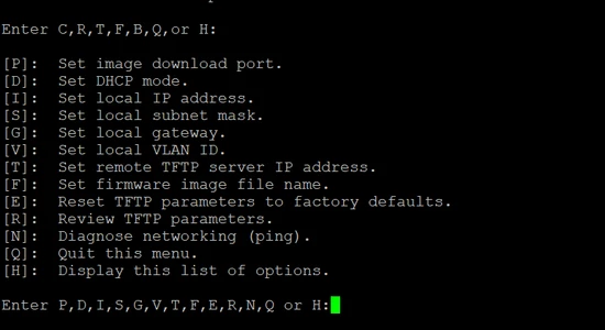

  1. Once the format procedure is completed, it will need to configure the IP address, subnet mask, and gateway for the interface where the cable is connected. The menu displayed after the format will appear as shown below. These settings can be configured by pressing [I] for the interface, then [S] for the subnet mask, and [G] for the gateway.
  1. Set Local IP address:
  1. Set Subnet-Mask:
  1. Set Gateway (This Should be TFTP-Server IP / Laptop IP).
It is possible to configure the Image Download Port by pressing [P]. This option is particularly useful when multiple cables are connected to the device. If only one laptop is connected, no additional configuration is necessary, as the FortiAuthenticator can automatically detect the active interface. In this case, since only Port 2 of the FortiAuthenticator is connected, defining an Image Download Port is not required.

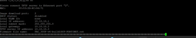

  1. To configure the TFTP Server, press [T]. Ensure that the download image is located in the correct TFTP root directory on the connected laptop.
  1. Enter the filename by pressing [F].

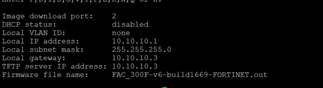

  1. After completing these configurations, these results can be reviewed by pressing [R].
  1. At this point, it is possible to initiate the image transfer by exiting this menu by pressing [Q], returning to the default menu, and then pressing [T] to start the TFTP firmware transfer

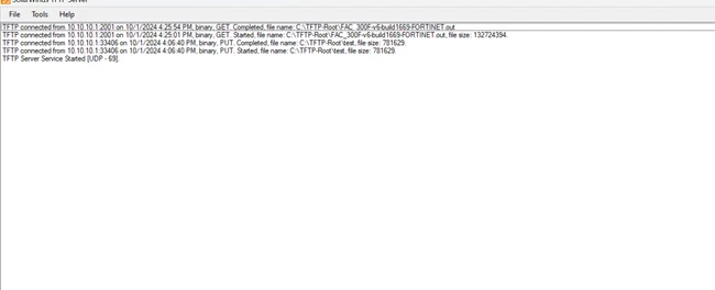

From the TFTP-Server, transfer details will be visible as below:
Rename the file to a shorter name while maintaining the original '.out' file extension if there are any reading errors, as explained below:
"tftp error 1 (file not found.) try to recover..."
