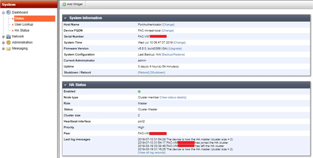

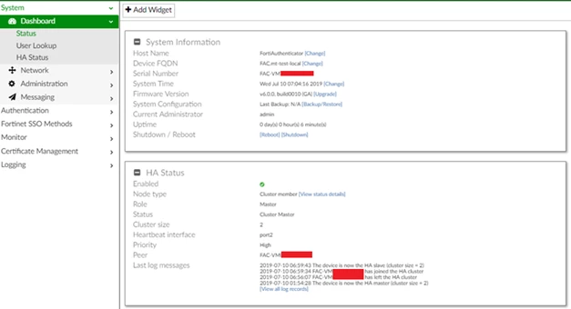

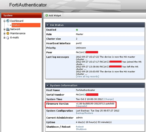

  1. Connect to the FortiAuthenticator Primary unit and select the upgrade option on the dashboard.

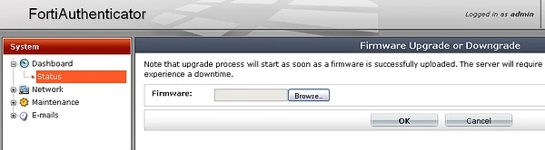

  1. Select Browse to upload the new firmware image and then select OK.
  1. The following confirmation dialog will be displayed. Select OK.
  1. The following message indicates that the firmware is uploading.
  1. After a few seconds, the firmware upgrade will start.
Starting from that point, the secondary member will assume the production traffic while the primary reboots to complete the upgrade process. Expect approximately 5 minutes to have the production network traffic back the old primary unit.
To upgrade the secondary HA member, connect to the device using the HA cluster member IP address as defined in the GUI menu below and operate the previous steps to upgrade the firmware.
Wait 5 minutes until the secondary finishes the upgrade process and the HA cluster rebuild is complete.

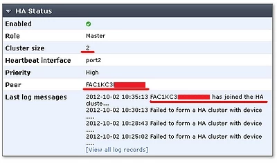

Connect to the Primary unit and check the HA status dashboard widget to validate the FortiAuthenticator HA cluster is operational.

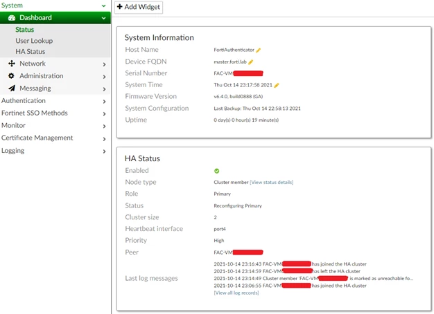

  1. After upgrading the secondary, the FortiAuthenticator HA cluster will perform a failover to the upgraded secondary and will start upgrading the initial primary node.
  1. A login screen for the FortiAuthenticator will be displayed when the upgrade is complete. After a few minutes, the cluster should be formed.
After approximately 5 minutes the FortiAuthenticator cluster will check which unit has the highest priority and will switch back to the initial primary.

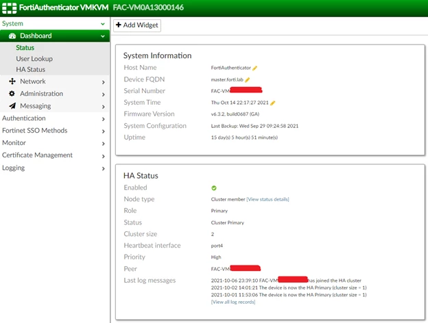

  1. Connect to the FortiAuthenticator Primary unit.

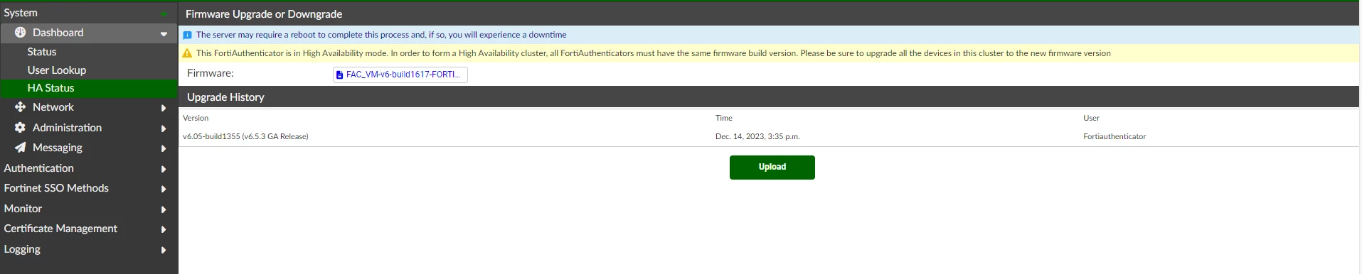

  1. Go to System -> Administration -> Firmware Upgrade. Select 'Upload a file' to upload the new firmware image and then select 'OK'.
  2.

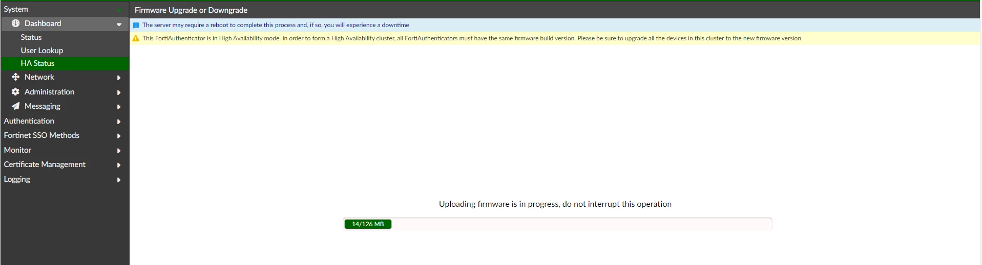

  1. The following confirmation dialog will be displayed. Select 'OK'.

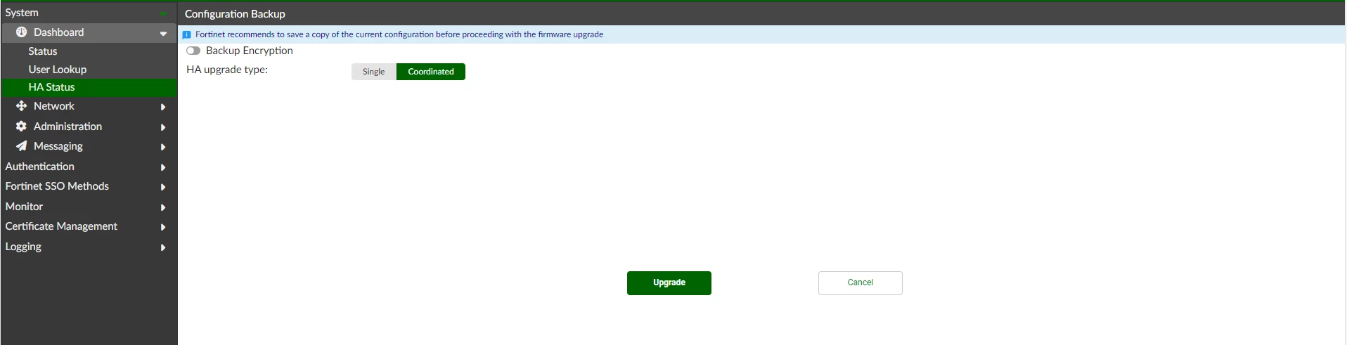

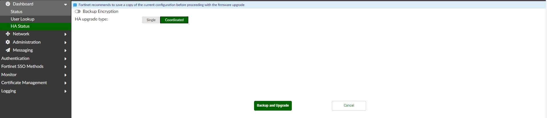

  1. After a few seconds, the FortiAuthenticator will prompt a message to save a backup of the current configuration as a best practice. Then choose the HA upgrade type:
  • Single: Perform an upgrade of only this node’s firmware.
  • Coordinated: Perform a coordinated upgrade of both cluster members.
After selecting 'Start Upgrade' the process should complete automatically.

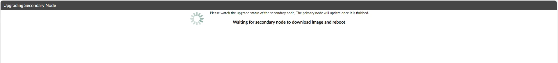

  1. After starting the upgrade, the secondary node will be upgraded first.

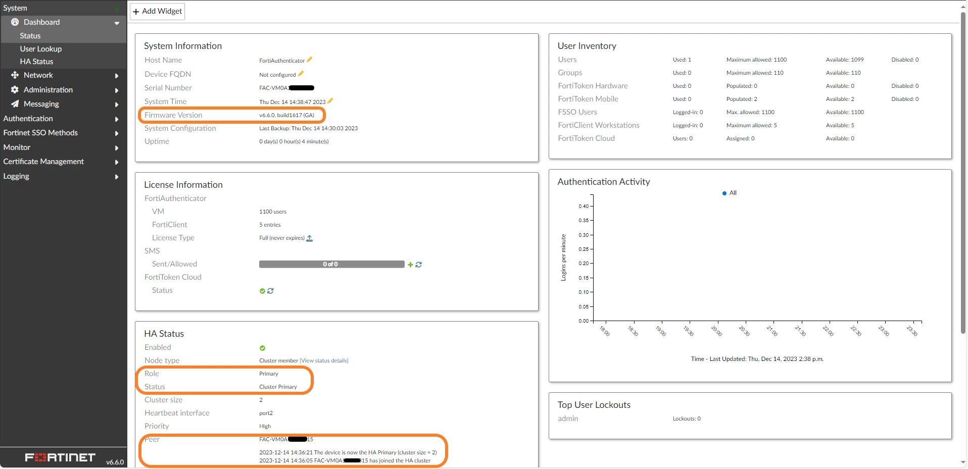

Tested with the latest firmware in the lab:

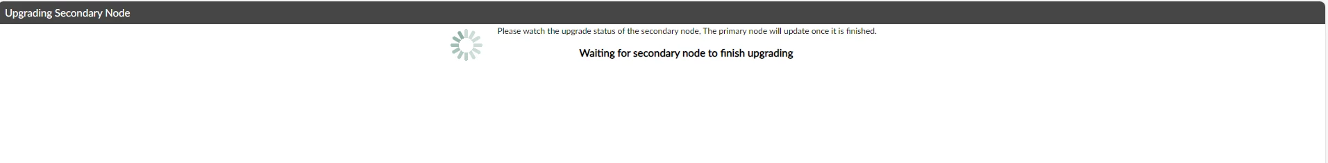

FortiAuthenticator HA Active - Passive coordinated upgrade :
  • Upgrade FortiAuthenticator HA cluster from v6.5.3 to v6.6.0.
  • Upgrade flow is as described above.
The secondary node has finished the upgrade and is taking the primary role. The primary node starting the upgrade now.

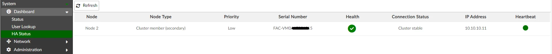

Verify HA status:
