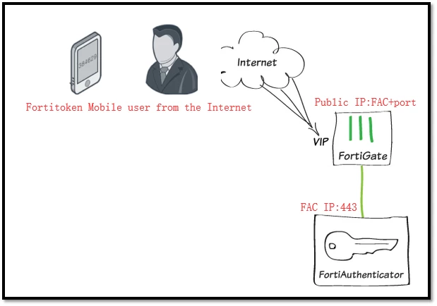

The following is the Network topology; in this scenario, the Port Forwarding had already been done on the FortiGate, and the focus is on the FortiAuthenticator configuration.

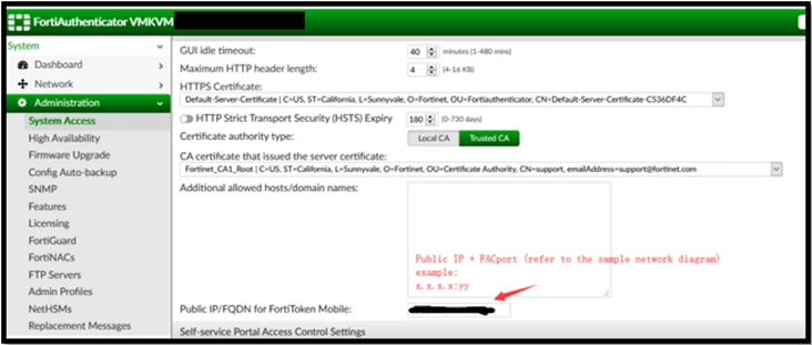

  1. Log in to the FortiAuthenticator from the GUI. Go to System -> Administration -> Public IP/FQDN for FortiToken Mobile -> Public IP + FortiAuthenticator port forwarding port.

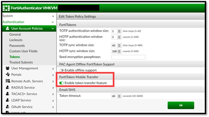

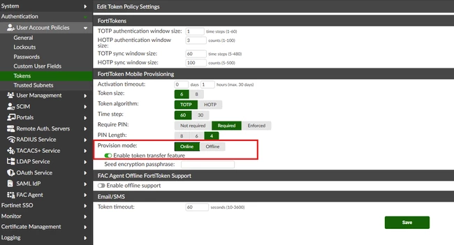

  1. Enable the FortiToken Transfer feature: Go to Authentication -> User Account Policies -> Tokens -> FortiToken Mobile Transfer and enable the FortiToken transfer feature.

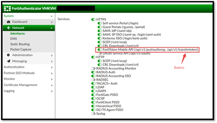

  1. Enable the FortiToken transfer service on the FortiAuthenticator interface (the interface which holding the FortiAuthenticator IP after port forwarding). Go to System -> Network -> Interface -> Edit interface and enable 'Fortitoken Mobile API'.

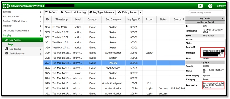

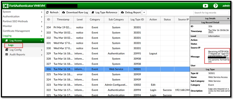

  1. The FortiToken transfer request will be received from a specific source IP address (the FortiToken Mobile public IP). Refer to the sample log above.

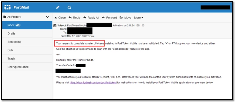

  1. The activation message and QR code will be sent to the respective email address configured under the user account assigned to this FortiToken mobile.
  1. An email to reactivate the FortiToken mobile on the other new unit will be received.
Starting from firmware version 6.6.1, under 'FortiToken Mobile Provisioning' select 'online' for 'Provision mode', then select 'Enable token transfer feature'.
