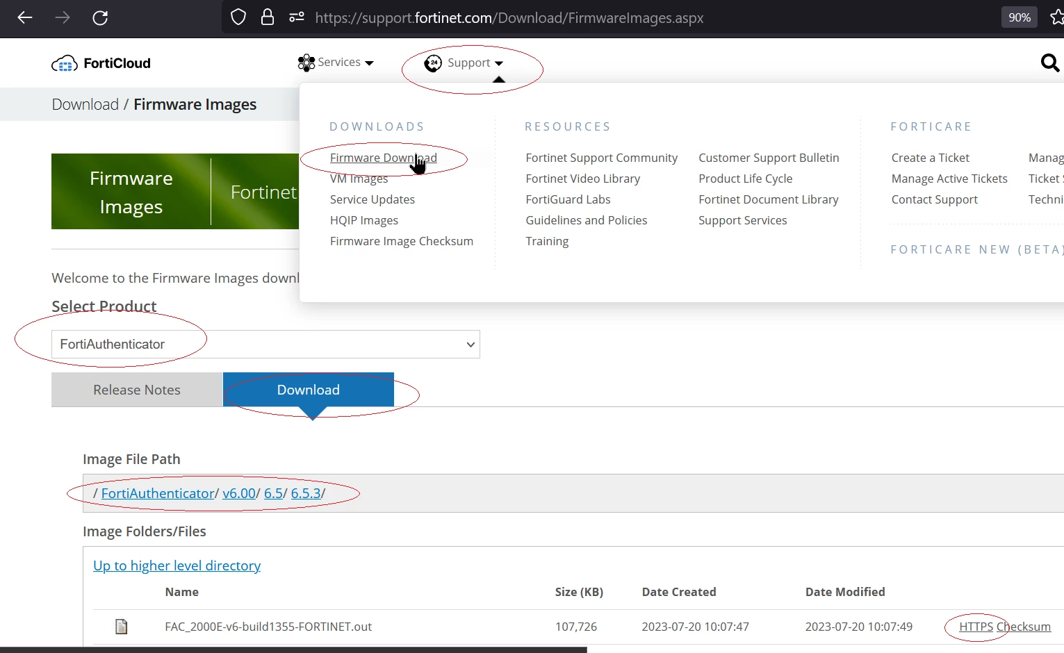

  1. Log in to the Customer Service & Support web portal here, and select the 'Support' option, followed by 'Firmware Download'.
  2. Select 'FortiAuthenticator' from the product selection dropdown list.
  3. Select 'Download' to get the available firmware list:

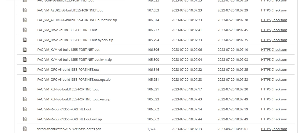

  4. Select the respective firmware version required, and select 'HTTPS' to start download.
Some naming intuitively suggests the platform the image is intended for. HV images are for HyperV, and Xen images are for Citrix and Aws.
KVM is also for other KVM-based hypervisors like Proxmox. VM is for VMware.
.out file is for upgrading an existing VM to a newer version. .zip is for deploying a new VM.

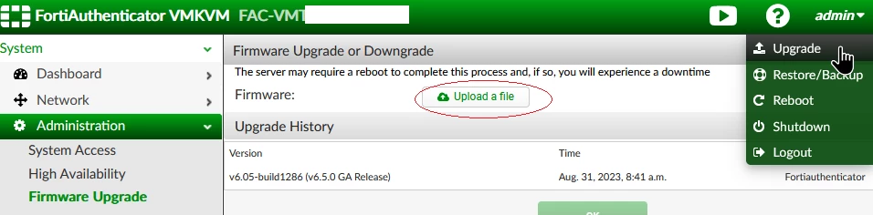

Manual upgrade firmware image via web UI:
  1. For both hardware and virtual machines, verify that a TFTP server is accessible to the FortiAuthenticator. Test the connection by performing a config backup or generating a debug report to ensure the device can read/write.
  2. Make sure to have the previous operating system version and a backup or snapshot already available or downloaded, in case a rollback is necessary.
  3. Login to FortiAuthenticator via web UI.
  4.  Browser to the below path: Go to System -> Administration -> Firmware Upgrade -> Upload a file or Select admin -> Upgrade -> Upload a file.

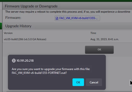

  1. Select 'Upgrade Firmware' to start the upgrade procedure.
  • Select the 'Upload a file' button to bring up the file window.
  • Select the firmware image file.
  • Select 'open' to select the respective firmware image file.
  • Select 'ok' to start uploading a firmware image file.
  • Select 'ok' to acknowledge final confirmation.
  • Select the 'Backup and Upgrade' button to start the upgrade procedure.

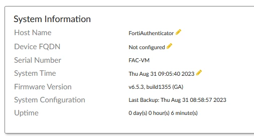

  1. Verify the FortiAuthenticator firmware version.
Go to: System -> Dashboard -> Status -> System Information.
