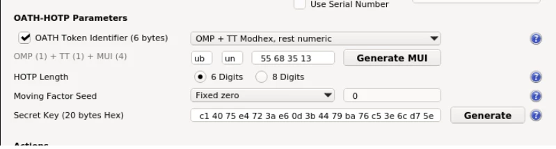

In the OATH-HOTP tab, choose the advanced configuration version. Select which slot to configure. The slots differ in how they are triggered:
Slot 1 - triggered after a short press of the button
Slot 2 - triggered after a three-second press of the button
Configure these options to ensure compatibility with FortiAuthenticator:
  • OATH Token Identifier: 'OMP + TT Modhex, rest numeric' Set the first two fields to 'ub', 'nu', then select 'Generate MUI' to generate a random identifier for the token
  • HOTP Length: Both options are compatible with FortiAuthenticator (controls the length of the token codes being generated)
  • Moving Factor Seed: Any of the three options is fine (Fixed zero | Fixed | Randomize, sets the initial counter value for generating token codes) for FortiAuthenticator
  • Secret Key: select the 'generate' button to get a new key.
Once configuration is done, click "Write Configuration". It will be required to choose a location for the log file, unless this was already done before. Continue with configuring other YubiKeys in the same manner (make sure they have unique Identifier and secret keys). The resulting csv file with configurations for all reprogrammed YubiKeys will be used for importing them into the FortiAuthenticator.

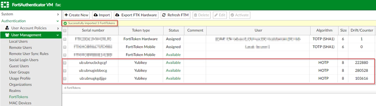

  1. Import the YubiKey CSV file
Go to Authentication -> User Management -> FortiTokens -> Import
Select file type "Yubikey file" and then choose the CSV file from step 1.
Note 1: If the error "Invalid Yubikey file, header is missing" is shown, verify that correct file is selected.
Note 2: If yes, also make sure that the first line of the file says "LOGGING START" (this is the expected header).
Once done, a message that the tokens were successfully imported will be shown.

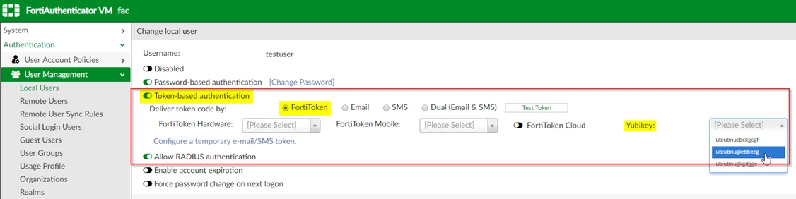

  1. Assigning YubiKey tokens to users
Go to Authentication -> User Management -> Local Users | Remote Users
Edit a user object. As with regular FortiTokens, first enable Token-based authentication, then select “FortiToken” as delivery. Choose one of the available YubiKey tokens from the drop-down menu on the right hand side. Save the change with 'OK'.

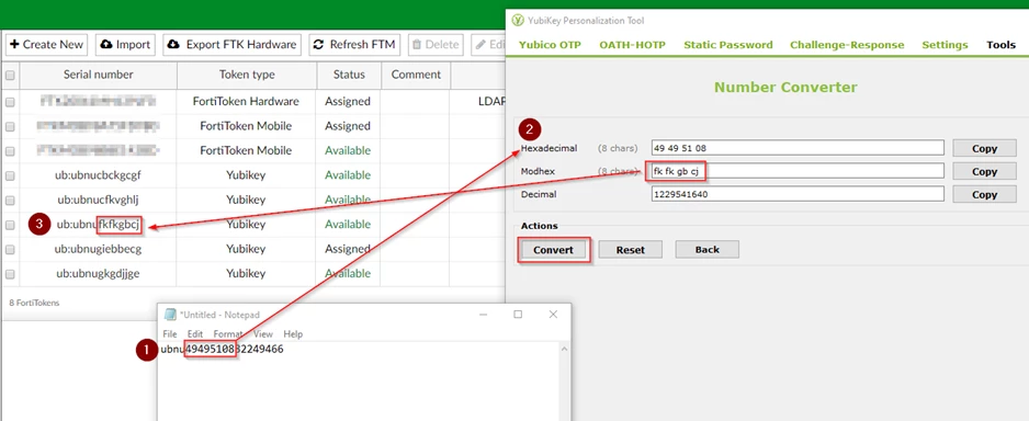

How to match a YubiKey to its serial number in FortiAuthenticator?:
If it is not sure which serial number matches to a certain YubiKey, use the following procedure to identify it:
  1. Press the YubiKey button to generate a code. Take the YubiKey identifier part (described above) of the code and remove the initial “ubnu”. The remainder is the hexadecimal representation of its unique ID (eight digits).
  2. Convert this hex number to modhex. Use the YubiKey Personalization Tool for this (Go to Tools tab -> Number Converter).
  3. Append this modhex number to “ub:ubnu”. The result is the serial number of the YubiKey as shown in FortiAuthenticator.
