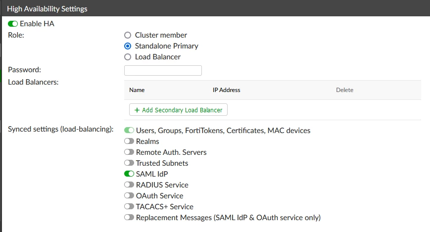

Starting in firmware version 6.6, more configuration can be synchronized. This is optional; settings are available under System -> Administration -> High Availability on the primary node. By default, the synchronization behavior is the same as in v6.5 and earlier.

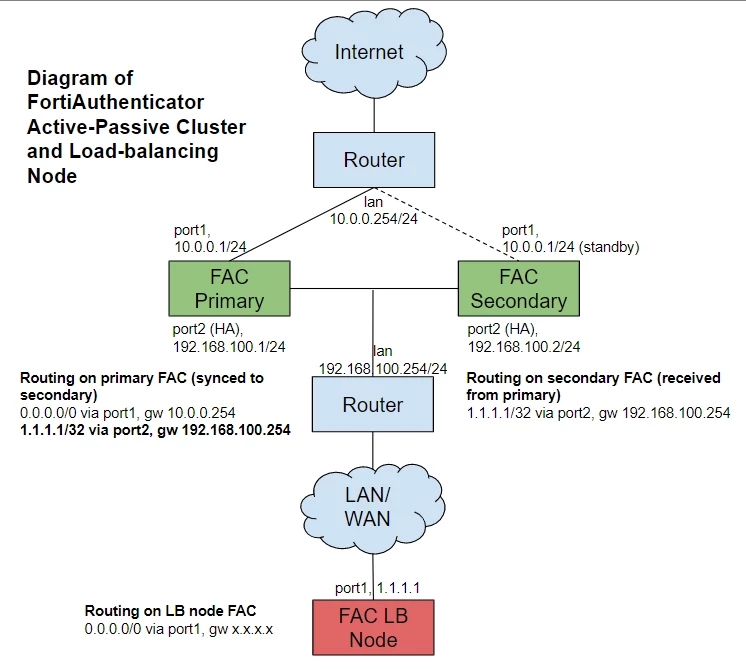

If the planned setup consists of an active-passive cluster and load-balancing nodes, not just a standalone primary with nodes, note that there are additional routing considerations:
  • The load-balancing node must be able to reach the active-passive cluster HA interfaces.
  • The active-passive cluster must be able to reach the load-balancing node via HA interfaces.

  • The load-balancing node must be able to reach the standalone primary on any specific interface or the cluster primary on its HA interface.
  • The primary must be able to reach the load-balancing node on any specific interface; if the primary is a cluster node, then it must be able to reach the load-balancing node via the HA interface.

  1. Enabling High Availability:
Once the primary is fully configured and the load-balancing nodes have the prerequisite configuration in place, High Availability can be enabled.
On the primary, set the following under System -> Administration -> High Availability:
  • Enable HA.
  • Set the Role to 'Standalone Primary'.
  • Set a pre-shared key to be used by the cluster.
  • If an active-passive cluster serves as primary, skip steps 1-3.
  • Add the IP addresses of any load-balancing nodes in the 'Load Balancers' table. Up to ten may be added.
  • If an active-passive cluster serves as primary, add a route to the load-balancing node IP on the primary; set the HA interface as the outgoing interface.
A routing diagram of an active-passive cluster with a load-balancing node:
Configuration on the primary (this is automatically mirrored to the secondary).

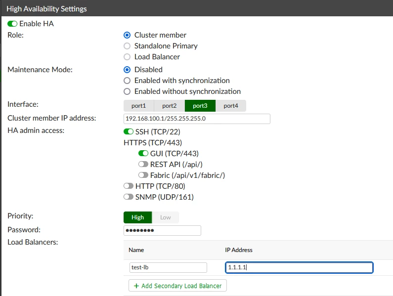

On the load-balancing nodes, set the following System -> Administration -> High Availability:
  • Enable HA.
  • Set the Role to 'Load Balancer'.
  • Add the primary IP address under 'Load Balancing primary IP address'.
  • If the primary is an active-passive cluster, set the HA interface IP of the primary unit (priority high) in the cluster.
  • Set the same pre-shared key as on the primary (or used by the primary cluster).
Set a route to the primary on the load-balancer node IF the primary is not reachable via the default route.
No HA interface needs to be configured on the load-balancing unit; FortiAuthenticator will use the interface as indicated by its routing table to communicate with other nodes in the load-balancing setup.
If a cluster serves as the primary node, leave the cluster HA settings untouched and only add the load-balancing nodes with their IP addresses.
