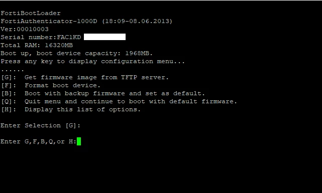

To downgrade hardware FortiAuthenticators, the best solution is to format it, then install the desired firmware version via TFTP and restore a previous configuration backup.
This process is very similar to doing the same with a FortiGate:
Technical Tip: Formatting and loading FortiGate firmware image using TFTP
  1. Reboot FortiAuthenticator.
  2. Interrupt the bootup when FortiAuthenticator displays 'Press any key to display configuration menu' by pressing any key.
  3. Type ‘F’ to format.
  4. Wait for FortiAuthenticator to come up again.
  5. Interrupt boot again as in step 2.
  6. Type ‘G’ to load firmware from TFTP.

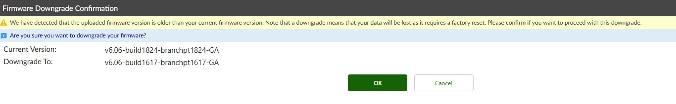

When uploading a firmware image with a lower version, the FortiAuthenticator will perform factory reset. The message below will be shown before the process proceeds:
The configuration backup must be from the same firmware version currently in use. It is not possible to restore a configuration backup from a different firmware version.
