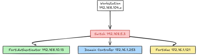

Topology:

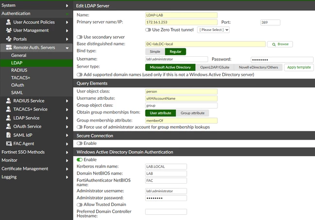

  1. Add FortiAuthenticator on a specific domain. Enable the option 'Windows Active Domain Authentication'.
2025-03-06 15_55_50-FortiAuthenticator and 19 more pages - Personal - Microsoft​ Edge.png

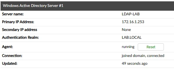

  1. After adding the FortiAuthenticator on a domain, check the results under Monitor -> Authentication -> Windows AD.

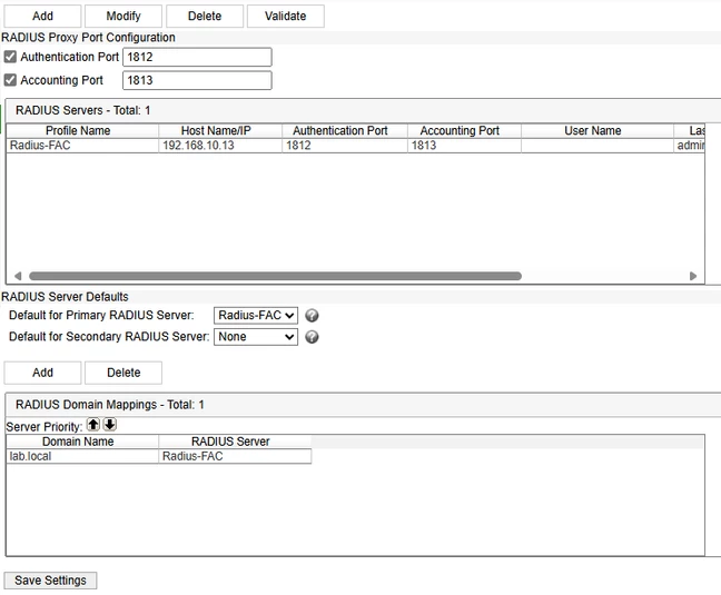

  1. Open the FortiNAC and go to the Network -> RADIUS -> Proxy and add the FortiAuthenticator settings.

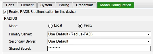

  1. While still on the FortiNAC, go to Network -> Inventory, select the switch configured to connect the workstation, enable the option RADIUS authentication, and select Proxy as the Mode. Choose the FortiAuthenticator and insert the Shared Secret.

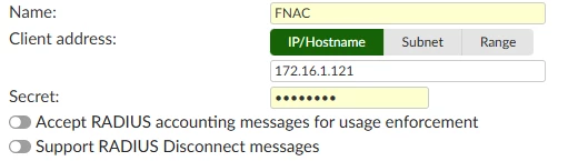

  1. Go to FortiAuthenticator to configure the RADIUS Client, Realm, and policy to authenticate the workstation (User and Machine).
    1. Go to Authentication -> RADIUS Service -> Clients.
    2. Add the client with the correct RADIUS secret.

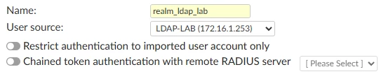

    1. Go to User Management -> Realms to add a realm to be used in a RADIUS policy. Select the LDAP server configured before as a source.

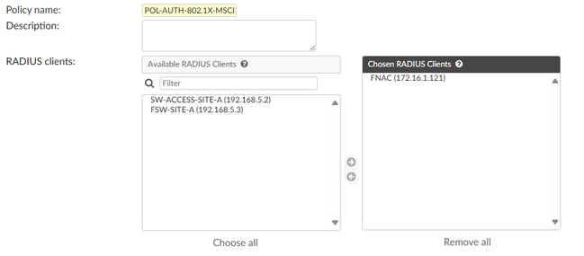

    1. Go to Authentication -> RADIUS Service -> Policies.
    2. In the RADIUS Client, add the FortiNAC configured as a client before.
2025-03-06 17_22_56-FortiAuthenticator and 19 more pages - Personal - Microsoft​ Edge.png

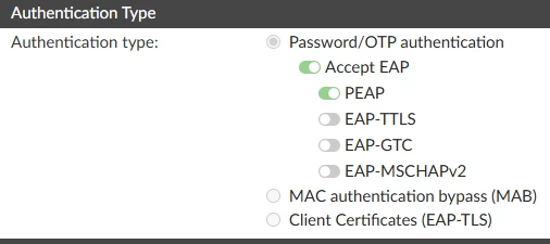

Under the Authentication Type, select Access EAP and PEAP.
    1. Under Identity Sources, check the option 'Use default realm...'. Enable the option to use Windows AD Authentication and filter by a group. This group needs to have all members who will be authenticated (users and machines). If necessary, add more than one group.

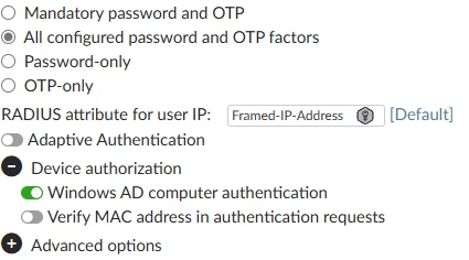

    1. In Authentication Factors, under Device authorization, enable the option 'Windows AD computer authentication'.
