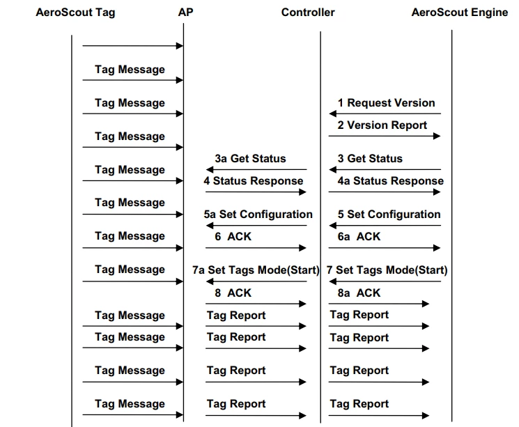

The issue typically occurs when users use the AeroScout engine to generate tag information. Real-Time Location Systems (RTLS) leverage Wi-Fi networks, Active RFID, sensors, and telemetry to track the real-time location and status of valuable assets. AeroScout, specifically, uses Wi-Fi networks to accurately track assets such as equipment and personnel.
The tag protocol operates between access points (APs) and the AeroScout engine. Fortinet's implementation of AeroScout supports tag messages transmitted in either IBSS (default) or WDS frame formats. However, Fortinet APs only receive and process tag frames in IBSS format.
