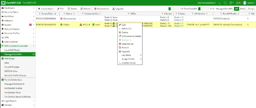

If the FortiAP was online once, it will show disconnected as per the screenshot below under managed FortiAPs. If the FortiAP was never online, it will not show the FortiAP.
CLI command and output that shows FortiAP offline:

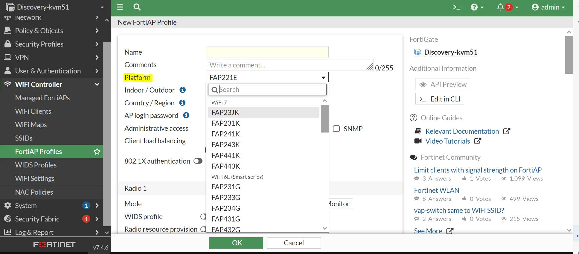

  2. If the platform profile/FortiAP Model is available on the FortiAP profiles, move to Step 4.
    Navigate to Wifi & Switch Controller -> FortiAP Profiles -> Create New -> Check the dropdown list for the Platform.

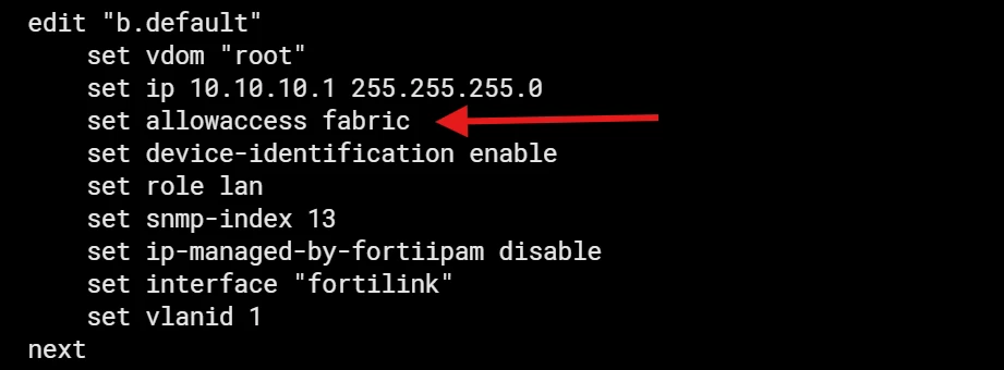

To activate CAPWAP on an interface, the Fabric option must be enabled. The FortiLink interface has this option enabled by default, but for other interfaces, such as a VLAN assigned to the FortiLink interface, the Fabric option must be enabled.

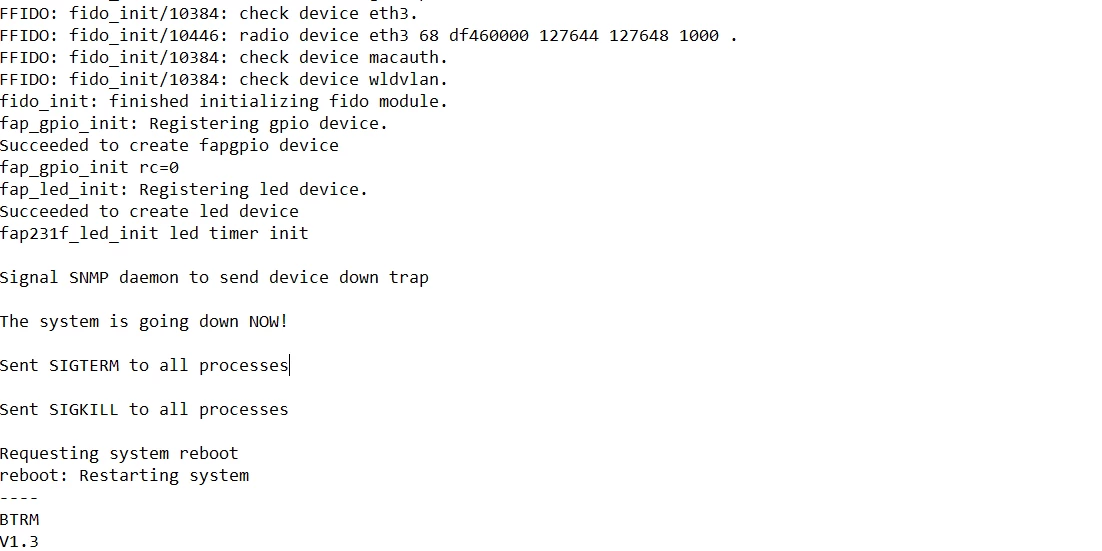

  1. Check for the AP console logs using wcfg to check the state of discovery or if the AP is going into a sulking state.
1(static) → 2(dhcp) → 3(dns) → 7(fortiapcloud) → 5(multicast) → 6(broadcast)
If it is stuck at one phase, contact L3 support to get the below logs.
diag wireless-controller wlac wtp_filter FP112B3X13000193 0-192.168.6.8:5246 2 <----- Replace the serial number and IP address of the FortiAP.
diagnose debug application cw_acd 0x7ff
diagnose debug enable
  1. Check for crash logs using the AP console.
kp
crash
cw_diag kernel-panic (Show the kernel panic output).
dmesg
cw_diag show all
diagnose wireless-controller  wlac -c wtp (Shows the status of the AP).
  • If kernel panic is seen in the output.
Action: Contact Fortinet Support
  • If no kernel panic is seen.
Action: Proceed to step 13.

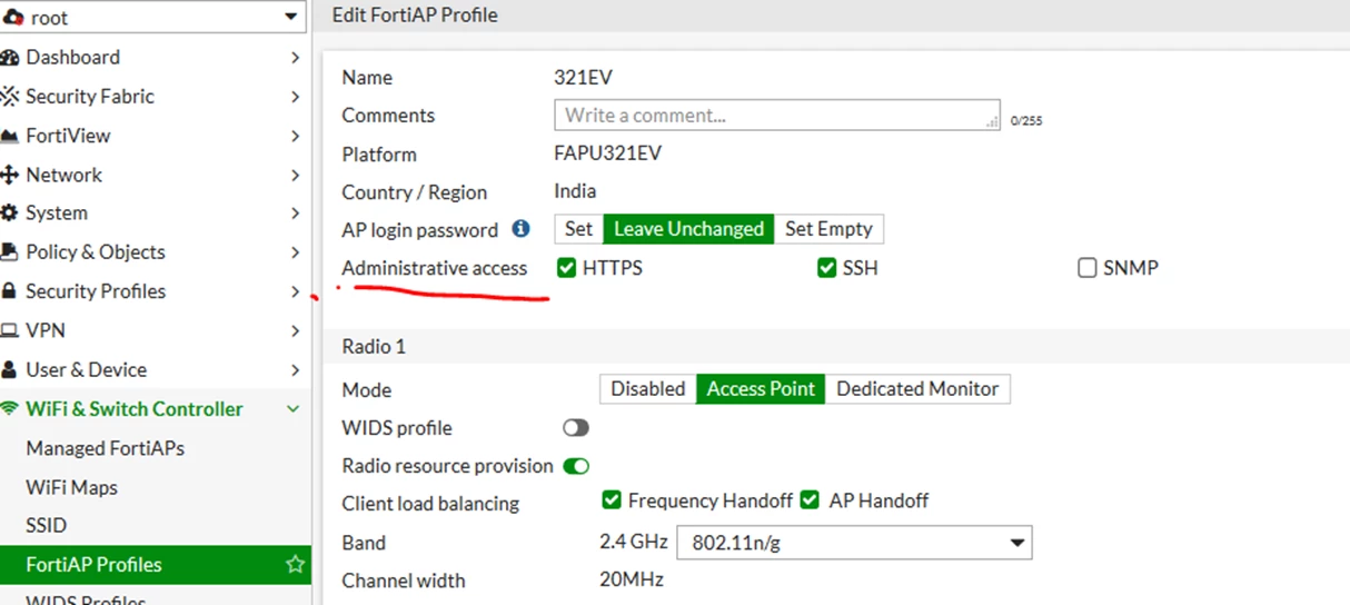

  • To take SSH or telnet access to the FortiAP, make sure that it is allowed in the FortiAP profile. (Wifi & Switch Controller -> FortiAP Profiles, edit the 'respective profile' and allow 'SSH').
