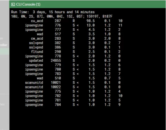

This article describes how to resolve an issue where cw_acd, a process that handles the wireless daemon for FortiAP, gets overloaded and shows heavy CPU spikes in a large-scale FortiAP-FortiGate Controller environment.
The spike can be seen on the FortiGate via the following CLI command:
diagnose sys top
Scope FortiGate/FortiAP v7.2 and above.

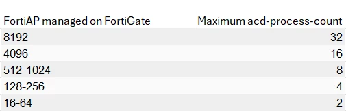

  1. Configure multiple processors for the wireless daemon (cw_acd).
It splits the total number of FortiAPs into smaller groups where each cw_acd process manages a group.
To configure multiple cw_acd processes in the global domain, use the following FortiGate CLI command:
config wireless-controller global
    set acd-process-count <0-32>
The process counts the maximum values to be set as per the following table:
For example, if there are 200 FortiAPs managed by a FortiGate, use set acd-process-count 4.
