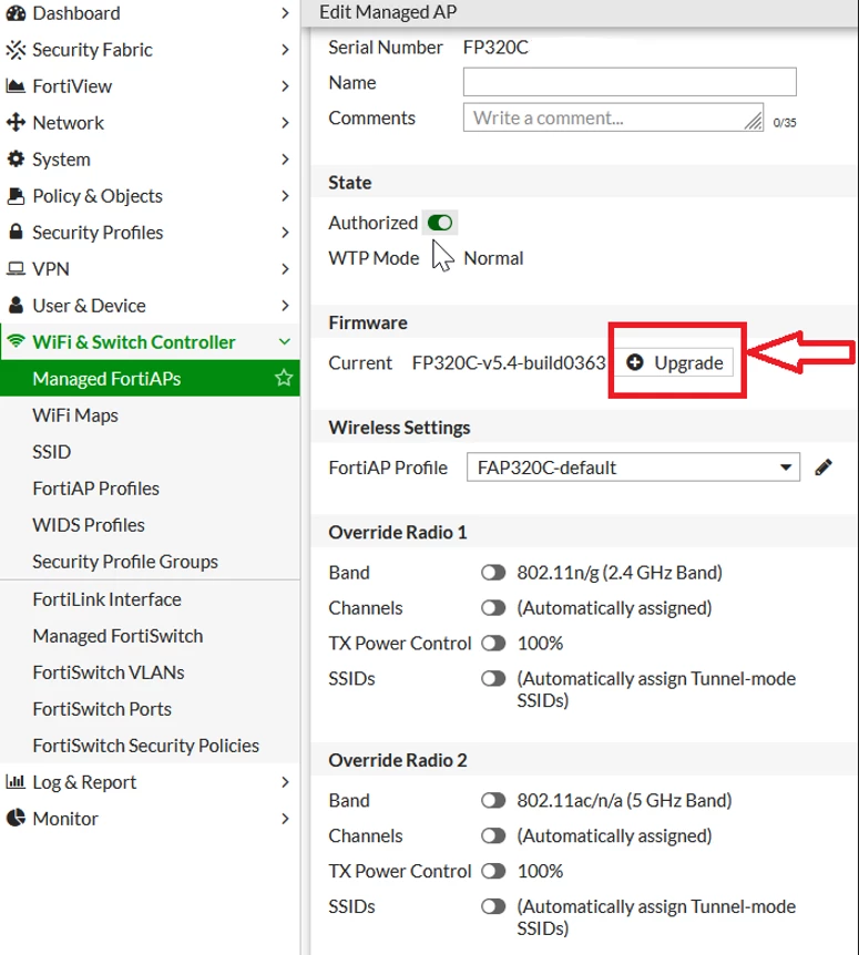

Method 1: To update FortiAP firmware: FortiGate GUI:
  1. Go to WiFi Controller & Switch Controller -> Managed FortiAPs.
  2. Select the FortiAP from the list and edit it.
  3. In FortiAP OS Version, select 'Upgrade'.
  4. Select Browse and locate the firmware upgrade file.
  5. Select 'OK'.
  6. When the upgrade process completes, select 'OK'.
The FortiAP restarts.
To upgrade multiple FortiAPs at a time, go to Managed FortiAPs on the FortiGate GUI, select multiple APs at a time, 'Right-click', and select  Upgrade.

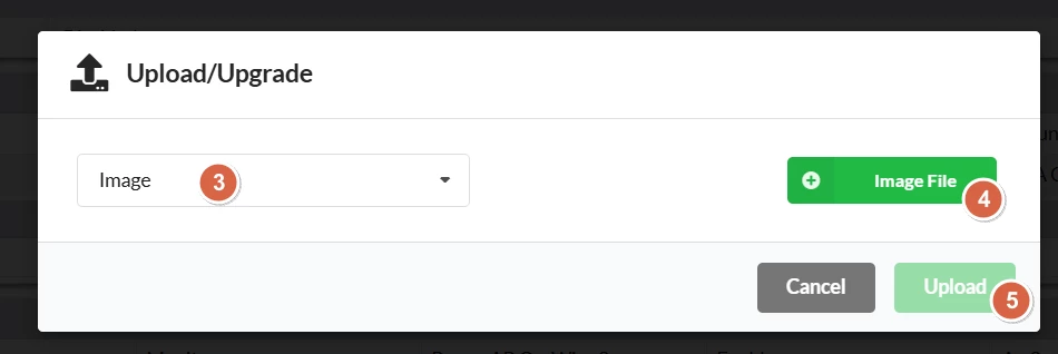

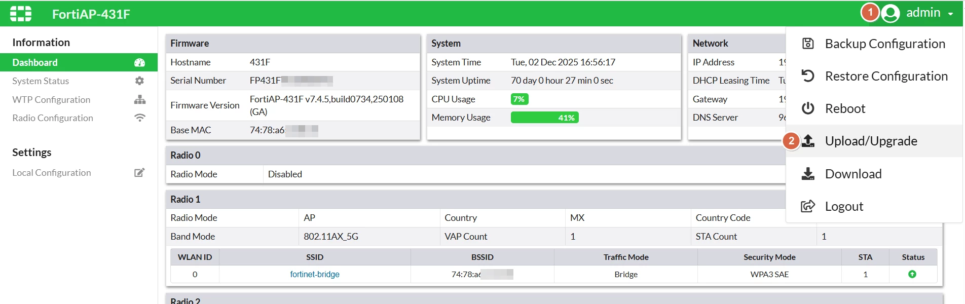

Method 4: To update FortiAP firmware: FortiAP GUI:
Step 1Step 1
Step 2Step 2
