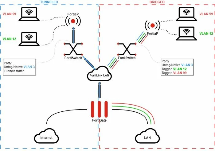

Client traffic comparisonClient traffic comparison
Bridge Mode (Local Bridge):
  • How it works: In Bridge mode, the SSID is like a bridge between the wireless and wired networks. It allows wireless devices to be part of the same network as wired devices. See how to configure one Bridge SSID on FortiGate here: Technical Tip: How to create a new Bridge SSID with its VLAN dedicated for users. In bridged mode, the AP sends the client's traffic to the edge switch port servicing the AP. Then, the traffic gets switched and/or routed to the wired network until it reaches its destination. The allowed VLAN should be configured on the edge switch as needed.

Tunnel Mode:
  • How it works: In Tunnel mode, the SSID creates a separate network (like a tunnel) for wireless devices. All wireless traffic is encapsulated, encrypted (if configured), and then sent to the central device (FortiGate) for processing. In fact, a new interface will be created on FortiGate with the SSID name. This will behave as a FortiGate VLAN. See how to configure one Tunnel SSID on FortiGate here: Defining a wireless network interface (SSID). Only the management VLAN can be configured on the edge switch.

General recommendations:
  • If simplicity and all devices on the same network are needed, bridge mode can work well for smaller setups.
  • For larger networks with stricter security and traffic control requirements, tunnel mode is recommended. It allows for better management, security, and scalability.
  • For guest and Internet-only networks, restrict traffic to the tunnel SSIDs.
  • Consider the use of a data tunneling solution for any data that is sensitive or subject to compliance regulations.
  • Tunnel traffic that cannot be secured or segmented if bridged.
  • Bridge traffic is when the client and resources are co-located, but the wireless controller (FortiGate in this case) is located somewhere else. This could, for example, be the case if FortiGate is the wireless controller, and it is hosted in a remote data center.
