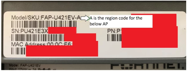

Silver Label: The region code will be mentioned on the silver label on the actual physical FortiAPs, as shown below.
See the region code mentioned right after the model.
