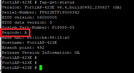

| Scope | The region code of a FortiAP can be retrieved from the FortiAP CLI itself with the command 'fap-get-status' or 'get system status': fap-get-status Version: FortiAP-431F v7.6.0,build0894,240808 (GA) Serial-Number: FP431FTFXXXXXXXX BIOS version: 04000011 BIOS data version: 4 System Part-Number: P24928-04 Hardware Revision Info: PVT Regcode: N Base MAC: 74:78:a6:c6:bf:c0 Hostname: FAP-431-LAB Branch point: 0894 Release Version Information: GA This region code is hard-coded for each FortiAP and cannot be changed. If an Access Point is received from a different region code of the country where it will be deployed, get in touch with the corresponding sales representative, since the equipment will probably need to be replaced. Refer to the following chart to see which countries this code is correlated with: Use the following Country Codes for the correct FAP product to be shipped. Note: W2/Newer models are FortiAP E series and later, i.e., FortiAP-42xE, S42xE, U42xEV, 32xE, S32xE, U32xEV, etc. | SKU suffix | Country | Suffix | | A | ARGENTINA | A | | ARUBA | A | | BAHAMAS | A | | CANADA | A | | GUAM | A | | HAITI | A | | AMERICAN_SAMOA | A | | BERMUDA | A | | CAYMAN_ISLANDS | A | | DOMINICA | A | | MARSHELL ISLANDS | A | | MEXICO | -N (G series & older), | | -A (K series & newer) | | NICARAGUA | A | | NORTHERN_MARIANA_ISLA | A | | PALAU | A | | ST_KITTS_NEVIS | A | | ST_LUCIA | A | | ST_VINCENT_GRENADIENS | A | | VIRGIN_ISLANDS | A | | PUERTO_RICO | A | | UNITED STATES | A | | BARBADOS | -N (G series & older), | | -A (K series & newer) | | BELIZE | -N (G series & older), | | -A (K series & newer) | | COLOMBIA | -N (G series & older), | | -A (K series & newer) | | DOMINICAN REPUBLIC | -N (G series & older), | | -A (K series & newer) | | GRENADA | -N (G series & older), | | -A (K series & newer) | | GUYANA | -N (G series & older), | | -A (K series & newer) | | HONDURAS | -N (G series & older), | | -A (K series & newer) | | MICRONESIA | -N (G series & older), | | -A (K series & newer) | | PANAMA | -N (G series & older), | | -A (K series & newer) | | E | AUSTRIA | E | | BELGIUM | E | | BOSNIA & HERZEGOVINA | E | | BULGARIA | E | | CENTRAL AFRICA | E | | CROATIA | E | | CYPRUS | E | | CZECH REPUBLIC | E | | DENMARK | E | | ESTONIA | E | | FINLAND | E | | FRANCE | E | | GERMANY | E | | GREECE | E | | GREENLAND | E | | HUNGARY | E | | ICELAND | E | | IRAQ | E | | IRELAND | E | | ISRAEL | -I (E series & older), | | -E (F series & newer) | | ITALY | E | | LATVIA | E | | LEBANON | E | | LIECHTENSTEIN | E | | LITHUANIA | E | | LUXEMBOURG | E | | MACEDONIA | E | | MALTA | E | | MYANMAR | E | | NETHERLANDS | E | | NETHERLANDS_ANTILLES | E | | NORWAY | E | | POLAND | E | | PORTUGAL | E | | ROMANIA | E | | SAUDIA ARABIA | E | | SERBIA & MONTENEGRO | E | | SLOVENIA | E | | SOUTH AFRICA | E | | SPAIN | E | | SWEDEN | E | | SWITZERLAND | E | | TURKEY | E | | UNITED ARAB EMIRATES | E | | UNITED_KINGDOM | E | | BELARUS | E | | KENYA | E | | MOZAMBIQUE | E | | ANGOLA | E | | MAURITANIA | E | | ALBANIA | E | | TANZANIA | E | | ZIMBABWE | E | | CONGO, DEMOCRATIC REPUBLIC OF THE | E | | CONGO, REPUBLIC OF THE | E | | COTE_D_IVOIRE (Ivory Coast) | E | | OMAN | E | | SLOVAKIA | E | | AZERBAIJAN | E | | GEORGIA | E | | MONACO | E | | TUNISIA | E (outdoor 5G ch 100-116 licensed only) | | AFGHANISTAN | E | | BENIN | E | | BHUTAN | E | | Botswana | E | | BURKINA_FASO | E | | CAMEROON | E | | CHAD | E | | ETHIOPIA | E | | FAEROE_ISLANDS | E | | FRENCH_GUIANA | E | | FRENCH_POLYNESIA | E | | GHANA | E | | GIBRALTAR | E | | GUADELOUPE | E | | Jordan | E | | LESOTHO | E | | LIBYA | E | | MADAGASCAR | E | | MALI | E | | ISLE OF MAN | E | | MARTINIQUE | E | | MAURITIUS | E | | MAYOTTE | E | | MOLDOVA | E | | MONTENEGRO | E | | NAMIBIA | E | | NIGER | E | | REUNION | E | | RWANDA | E | | ST_BARTHELEMY | E | | ST_MARTIN | E | | ST_PIERRE_MIQUELON | E | | SIERRA LEONE | E | | SURINAME | E | | TOGO | E | | TURKS_CAICOS | E | | UGANDA | E | | WALLIS_FUTUNA | E | | YEMEN | E | | ZAMBIA | E | | Djibouti | E | | Gabon | E | | Gambia | E | | Liberia | E | | Somalia | E | | QATAR | E | | Swaziland | E | | I | ALGERIA | I | | ARMENIA | I | | BAHRAIN | I | | BRUNEI DARUSSALAM | I | | EGYPT | Y (from E Model) | | I (D or older Models) | | ISRAEL | -I (E series & older), | | -E (F series & newer) | | KUWAIT | I | | MONGOLIA | I | | MOROCCO | I | | MALDIVES | I | | NIGERIA | I | | SENEGAL | I | | SRI LANKA | I | | TURKMENISTAN | I | | J | JAPAN | J | | K | KOREA_REPUBLIC | K | | N | AUSTRALIA | -N (G series & older), | | -H (K series & newer) | | BRAZIL | N | | BOLIVIA | N | | CHILE | N | | COSTA RICA | N | | GUATEMALA | N | | ECUADOR | N | | EL SALVADOR | N | | FIJI | -N (G series & older), | | -H (K series & newer) | | HONG KONG | -N (G series & older), | | -H (K series & newer) | | JAMAICA | N | | MEXICO | -N (G series & older), | | -A (K series & newer) | | NEW_ZEALAND | -N (G series & older), | | -H (K series & newer) | | PAPUA NEW GUINEA | N | | PARAGUAY | N | | PERU | N | | TRINIDAD & TOBAGO | N | | URUGUAY | N | | CHRISTMAS_ISLAND | -N (G series & older), | | -H (K series & newer) | | MALAWI | -N (G series & older), | | -H (K series & newer) | | VANUATU | -N (G series & older), | | -H (K series & newer) | | VENEZUELA | N | | BARBADOS | -N (G series & older), | | -A (K series & newer) | | BELIZE | -N (G series & older), | | -A (K series & newer) | | COLOMBIA | -N (G series & older), | | -A (K series & newer) | | DOMINICAN REPUBLIC | -N (G series & older), | | -A (K series & newer) | | GRENADA | -N (G series & older), | | -A (K series & newer) | | GUYANA | -N (G series & older), | | -A (K series & newer) | | HONDURAS | -N (G series & older), | | -A (K series & newer) | | MICRONESIA | -N (G series & older), | | -A (K series & newer) | | PANAMA | -N (G series & older), | | -A (K series & newer) | | V | CAMBODIA | V | | LAOS | V | | THAILAND | V | | S | CHINA | C (from E Model) | | S/C (D or older Models) | | PHILIPPINES | S | | SINGAPORE | S | | INDIA | D (from E Model) | | S (D or older Models) | | MACAU | S | | MALAYSIA | S | | NEPAL | B (from E Model) | | S (D or older Models) | | PAKISTAN | B (from E Model) | | S/C (D or older Models) | | VIETNAM | S | | T | TAIWAN | T | | U | UKRAINE | U | | P | RUSSIA | P | | KAZAKHSTAN | P | | UZBEKISTAN | P | | F | BANGLADESH | B (from E Model) | | F (D or older Models) | | INDONESIA | F | | C | CHINA | C (from E Model) | | S/C (D or older Models) | | PAKISTAN | B (from E Model) | | S/C (D or older Models) | | D | INDIA | D (from E Model) | | S (D or older Models) | | Y | EGYPT | Y (from E Model) | | I (D or older Models) | | B | BANGLADESH | B (from E Model) | | F (D or older Models) | | NEPAL | B (from E Model) | | S (D or older Models) | | PAKISTAN | B (from E Model) | | S/C (D or older Models) | | H | AUSTRALIA | -N (G series & older), | | -H (K series & newer) | | FIJI | -N (G series & older), | | -H (K series & newer) | | HONG KONG | -N (G series & older), | | -H (K series & newer) | | NEW_ZEALAND | -N (G series & older), | | -H (K series & newer) | | CHRISTMAS_ISLAND | -N (G series & older), | | -H (K series & newer) | | MALAWI | -N (G series & older), | | -H (K series & newer) | | VANUATU | -N (G series & older), | | -H (K series & newer) | | W | NoCountry | W | |
