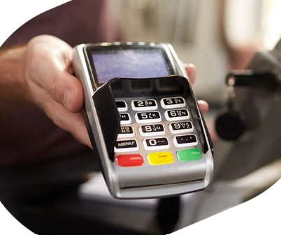

This article describes how to troubleshoot connectivity issues with legacy wireless devices/Scanners/POS machines.
In today's fast-paced digital world, legacy Wi-Fi devices like scanners and POS machines can often lag behind the latest Wi-Fi standards. This can lead to connectivity issues and slow performance.
